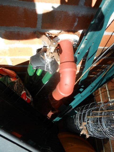

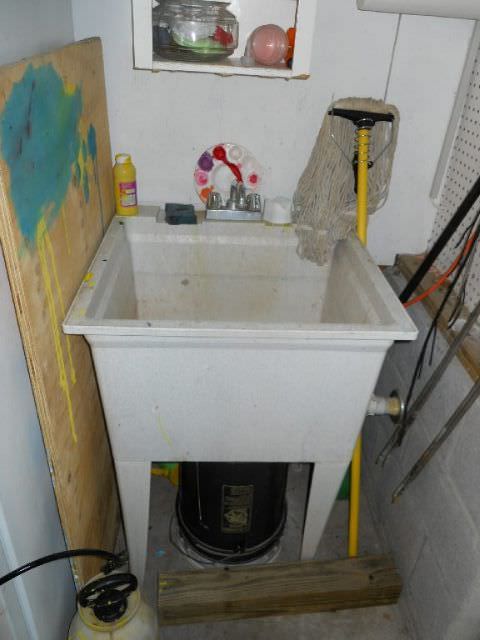

mgbinspect Posted August 31, 2010 Report Share Posted August 31, 2010 I haven't run across a suspected gray water system in about ten years. This laundry tub is in an attached garage - an addition. The original attached garage was converted to a recreation room. Click to Enlarge 40.83 KB Click to Enlarge 57.25 KB The drain line for it goes directly out the rear foundation wall and turns down through a concrete landing slab. The home is on septic and the main line leaving the crawlspace for the septic tank is at the opposite end of the home. Of course, it could join up with the main drain line headed to the septic tank, but it's not likely, since it means they'd have to run the pipe underground for about forty-five feet. No evidence of a gray water sump was obvious. My guess is that it's just under the slab. The present owner of the home said it made sense, because when they were planting near the deck the soil seemed unusually wet once they got down a bit. The previous seller did other cheesy things like tap a cut off extension cord into the water heater breaker for incoming generator current, so I think a gray water system is a pretty good bet here. Quote Link to comment Share on other sites More sharing options...
Rocon Posted August 31, 2010 Report Share Posted August 31, 2010 So you do you think the pipe in photo 2 dispurses water directly into the soil by the deck? If so I would not consider it a gray water system. Quote Link to comment Share on other sites More sharing options...
mgbinspect Posted August 31, 2010 Author Report Share Posted August 31, 2010 So you do you think the pipe in photo 2 disperses water directly into the soil by the deck? If so I would not consider it a gray water system. 'There's no easy way of knowing, but the common gray water system from days gone by would be something like a buried perforated fifty-five gallon drum filled with and surrounded by gravel. I am, however, not eluding to any approved eco system that might be a good thing. This would be a jerry rigged system, which has not been approved in our area for quite some time. Quote Link to comment Share on other sites More sharing options...
Rocon Posted August 31, 2010 Report Share Posted August 31, 2010 Out of curriosity how did you write it up, and what were your sugestions? Quote Link to comment Share on other sites More sharing options...
mgbinspect Posted August 31, 2010 Author Report Share Posted August 31, 2010 Out of curiosity how did you write it up, and what were your suggestions? "The drain line for the utility sink in the attached garage does not appear to join up with the central waste water system. It may go to a gray water system - a sump designed to re-introduce the water directly to the earth. These systems were common many years ago, but are no longer approved in most areas. Attach the drain line to the central waste water system." Quote Link to comment Share on other sites More sharing options...
