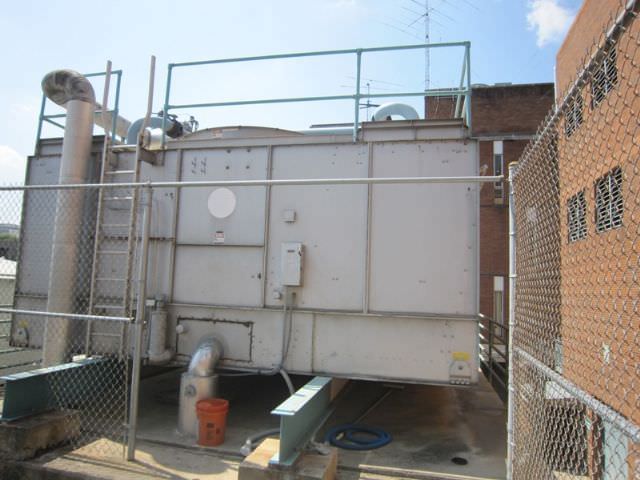

MPdesign Posted September 1, 2010 Report Share Posted September 1, 2010 Exactly when is it proper to say "2 cell cooling tower" vs 2 cooling towers? ie. the attached. Click to Enlarge 40.66 KB Click to Enlarge 54.52 KB Link to comment Share on other sites More sharing options...
mgbinspect Posted September 1, 2010 Report Share Posted September 1, 2010 Terence McCann is your man. You're talking his old stomping ground for many years. He can tell you more than you ever needed to know. If you need the info quick shoot him a PM or e-mail. Link to comment Share on other sites More sharing options...
Terence McCann Posted September 1, 2010 Report Share Posted September 1, 2010 What are you trying to accomplish Joe? Two cooling towers denotes two physically separate towers. From another web site: A dual-cell cooling tower consists of two attached towers, each with their own axial fan.Therefore a dual cell cooling tower has two axial fans, while a single cell cooling tower has one. Each manufacture might have a different arrangement for accomplishing the same thing. Do you have a make, model and serial from the tower shown in the picture? Link to comment Share on other sites More sharing options...
MPdesign Posted September 1, 2010 Author Report Share Posted September 1, 2010 Clients.. I have a meeting coming up where I called the cooling tower in the picture a 2 cell cooling tower. Word on the street is that it is 2 cooling towers and I will be discussing with the client. I just want to confirm the correct terminology. Link to comment Share on other sites More sharing options...
Terence McCann Posted September 1, 2010 Report Share Posted September 1, 2010 Clients.. I have a meeting coming up where I called the cooling tower in the picture a 2 cell cooling tower. Word on the street is that it is 2 cooling towers and I will be discussing with the client. I just want to confirm the correct terminology. If you have the make and model default to manufacture terminology. Link to comment Share on other sites More sharing options...
MPdesign Posted September 1, 2010 Author Report Share Posted September 1, 2010 Baltimore Aircoil Co Mod 3547-2CM Ser 87400989 Link to comment Share on other sites More sharing options...
Terence McCann Posted September 1, 2010 Report Share Posted September 1, 2010 Baltimore Aircoil Co Mod 3547-2CM Ser 87400989 Call BAC or call your local sales rep and ask them what type of tower it is. Link to comment Share on other sites More sharing options...
MPdesign Posted September 1, 2010 Author Report Share Posted September 1, 2010 Thanks Terry. Link to comment Share on other sites More sharing options...
MPdesign Posted September 1, 2010 Author Report Share Posted September 1, 2010 For the good of people in the future... For BAC: Model: 3547-2CM yields the following information 3000 series, 547 sometimes correlated *roughly* to tonnage but not in this case, -2 tells us 2 cell, CM is accessories/options For general correlation of tonnages (which is many times wrong) and general data - see below. http://www.baltimoreaircoil.com/english ... ta_BAC.pdf This tower is 2 cell, 2@5hp motors, single speed fans, 850 total tons Link to comment Share on other sites More sharing options...
