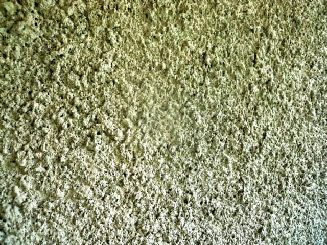

mgbinspect Posted September 2, 2010 Report Share Posted September 2, 2010 OK, all you stucco experts out there: What is the name for this traditional stucco finish that looks like the stucco was literally spattered on. They actually used a tool that flicked it on the surface with metal tines like you'd see in an old music box. It's not pebble-dash - no pebbles. Just strait consistently spattered cement stucco. Click to Enlarge 130.04 KBfield. Quote Link to comment Share on other sites More sharing options...
Ben H Posted September 2, 2010 Report Share Posted September 2, 2010 Booger.....[:-dev3] Quote Link to comment Share on other sites More sharing options...
hausdok Posted September 2, 2010 Report Share Posted September 2, 2010 Hi, I think that you are thinking of a dash coat; however, there are about a half dozen different types of dash coats and about 30 different types of finishes for traditional 3-coat stucco. Go to this link for descriptions and photos of the various types of stucco finishes. http://www.tsib.org/plastertextures.shtml#lightdash ONE TEAM - ONE FIGHT!!! Mike Quote Link to comment Share on other sites More sharing options...
mgbinspect Posted September 2, 2010 Author Report Share Posted September 2, 2010 Hi, I think that you are thinking of a dash coat; however, there are about a half dozen different types of dash coats and about 30 different types of finishes for traditional 3-coat stucco. Go to this link for descriptions and photos of the various types of stucco finishes. http://www.tsib.org/plastertextures.shtml#lightdash ONE TEAM - ONE FIGHT!!! Mike Perfect! That's precisely what I needed and will save it to my link library. Thanks Mike. PS. Around here, there is a pebble-dash, which is quite popular - gaudy I think. It has little river rocks ranging in size between large peas to marbles. Quote Link to comment Share on other sites More sharing options...

Gonzalezstucco Posted May 23, 2012 Report Share Posted May 23, 2012 that texture is done in several ways depending how large u want the popcorn the size depends on the bristle or brush Wat you do is dip it the stucco base then lightly jab your wrist to get that popcorn finish its easy once you get the technique this is a custom one that is there many ways to texture stucco some ugly some luxurious i cant post a link due to terms other wise i would Quote Link to comment Share on other sites More sharing options...
