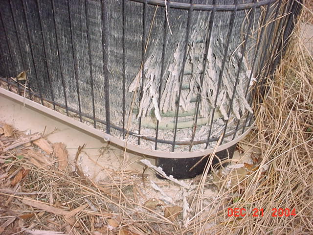

fyrmnk Posted December 21, 2004 Report Share Posted December 21, 2004 Hi all. On an inspection today, I found this outdoor unit with obvious corrosion/deterioration on one corner. The unit is a 10 y/o Lennox. The fins in the discolored area were very brittle and turned to dust when touched. The tubes were green with corrosion. An above ground swimming pool is about 15' away. I would guess a chemical has been spilled on it at some point. I couldn't operate it due to exterior temps. and assume it will need replaced and referred to HVAC tech. Any ideas as to cause of this or is the chemical thing likely??? Thanks in advance. Download Attachment: DSC00067.JPG 158.07 KB Link to comment Share on other sites More sharing options...
allspec33351 Posted December 21, 2004 Report Share Posted December 21, 2004 Urine (dog?) Captain Link to comment Share on other sites More sharing options...
Brian G Posted December 21, 2004 Report Share Posted December 21, 2004 Wow, very strange. Never seen anything like that before. Capt'n's guess ain't bad, but who the heck knows? Brian G. Link to comment Share on other sites More sharing options...
Bill Kibbel Posted December 21, 2004 Report Share Posted December 21, 2004 Canis Urina (Doggy Tinkle) The uric acid dissolves the fins rapidly. If you haven't seen this before, just wait, you will. This ain't a few bent fins. It needs replacement. Link to comment Share on other sites More sharing options...

kurt Posted December 22, 2004 Report Share Posted December 22, 2004 Yup. Dog pee. It might have been pool chemical, but it would take a pretty heavy concentrated dose to do that. Link to comment Share on other sites More sharing options...
kevin846 Posted December 22, 2004 Report Share Posted December 22, 2004 Thats a close second to a fire hydrant. My money is on the dog piss. Link to comment Share on other sites More sharing options...
