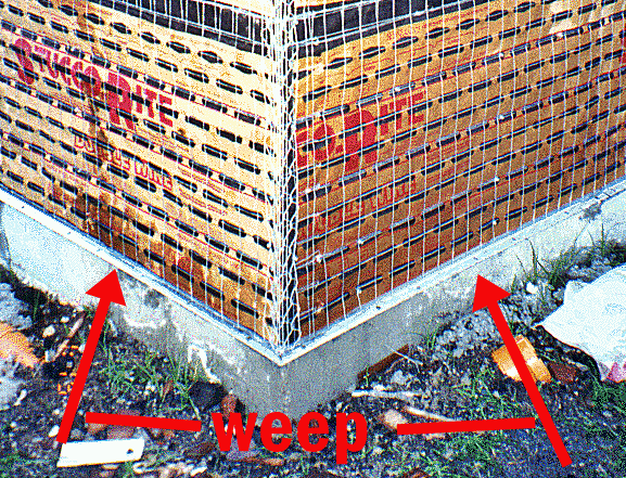

phmcminn Posted January 20, 2011 Report Share Posted January 20, 2011 I have a 1927 stucco bungalow in LA that a plumber has opened up the wall to replace the 84 year old drain pipes. Since members of this thread are familiar with line wire stucco (which this has), the stucco extends below the sill plate below grade and there are no weep screeds of course. I have the K lath referred to here to patch it and my question is how far below the sill plate should the metal lath extend? Short of grading the soil away from the foundation, it looks like this is a common problem for this old construction. The 2 x 6 tar coated sill plate sites on about 6 " layers of brick on the perimeter and the rest is pier support foundation that I can see in the crawl space. Thanks in advance for your suggestions and resource direction. Quote Link to comment Share on other sites More sharing options...
Marc Posted January 20, 2011 Report Share Posted January 20, 2011 I have a 1927 stucco bungalow in LA that a plumber has opened up the wall to replace the 84 year old drain pipes. Since members of this thread are familiar with line wire stucco (which this has), the stucco extends below the sill plate below grade and there are no weep screeds of course. I have the K lath referred to here to patch it and my question is how far below the sill plate should the metal lath extend? Short of grading the soil away from the foundation, it looks like this is a common problem for this old construction. The 2 x 6 tar coated sill plate sites on about 6 " layers of brick on the perimeter and the rest is pier support foundation that I can see in the crawl space. Thanks in advance for your suggestions and resource direction. I think you will find that information in ASTM C 1063 of which I do not have a copy. I generally look for the screed at 1 1/2 inches below the sill plate. As for the lack of a screed on this 84 year old home, I wouldn't bother with mentioning it in the report unless there was evidence of moisture intrusion issues stemming from this missing screed. Marc Quote Link to comment Share on other sites More sharing options...
Rocon Posted January 21, 2011 Report Share Posted January 21, 2011 Originally posted by phmcminn I have a 1927 stucco bungalow in LA that a plumber has opened up the wall to replace the 84 year old drain pipes. Since members of this thread are familiar with line wire stucco (which this has), the stucco extends below the sill plate below grade and there are no weep screeds of course. I have the K lath referred to here to patch it and my question is how far below the sill plate should the metal lath extend? Short of grading the soil away from the foundation, it looks like this is a common problem for this old construction. The 2 x 6 tar coated sill plate sites on about 6 " layers of brick on the perimeter and the rest is pier support foundation that I can see in the crawl space. Thanks in advance for your suggestions and resource direction. ASTM C 1063 requires 2 inches below the sill plate. Quote Link to comment Share on other sites More sharing options...
patt Posted January 21, 2011 Report Share Posted January 21, 2011 ASTM C1063 - 06 1" minimum. 7.11.5 Foundation Weep Screedââ¬âFoundation weep screed shall be installed at the bottom of all steel or wood framed exterior walls to receive lath and plaster. Place the bottom edge of the foundation weep screed not less than 1 in. (25 mm) below the joint formed by the foundation and framing. The nose of the screed shall be placed not less than 4 in. (102 mm) above raw earth or 2 in. (51 mm) above paved surfaces. The weather resistive barrier and lath shall entirely cover the vertical attachment flange and terminate at the top edge of the nose or ground flange. Quote Link to comment Share on other sites More sharing options...

phmcminn Posted January 21, 2011 Report Share Posted January 21, 2011 Dale, is that a caulk seal at the slab join? No weep screed that I can see there. The photos are of a product commonly referred to as "Stucco-Rite" or "K-Lath". It is very common to find 28" x 96" sheets of this product on gable ends. As long as the sheets were fastened properly, the cement plaster stucco will "key" into the wire. Click to Enlarge 450.79 KB Quote Link to comment Share on other sites More sharing options...
Dale McNutt Posted January 24, 2011 Report Share Posted January 24, 2011 It's right there. (weep) Remember when patching....."paper to paper and lath to lath". The curse of paper-backed lath is/was leaking. This is why during the last building boom, most SoCal tract builders went back to the old 1 1/2-#17 stucco wire and furring nails. Too many cracks and too many leaks in the past. Click to Enlarge 248.11 KB Quote Link to comment Share on other sites More sharing options...
