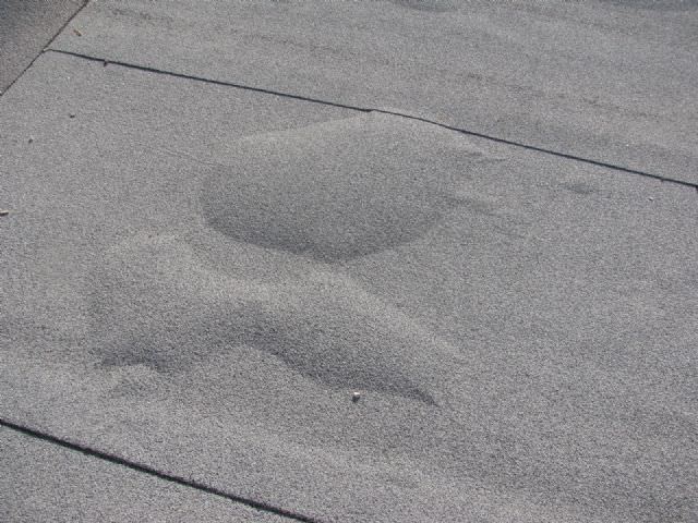

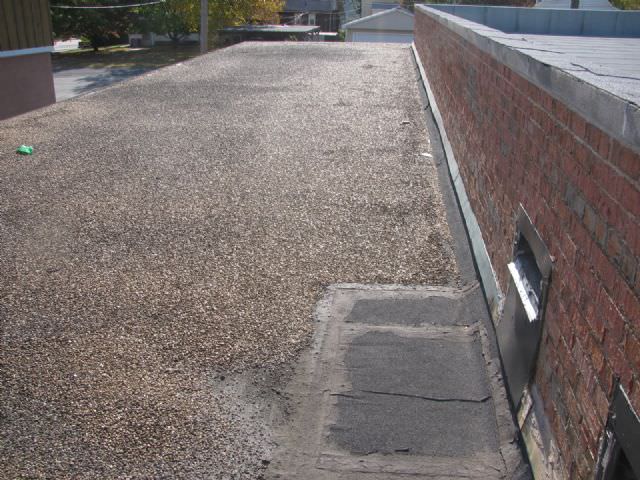

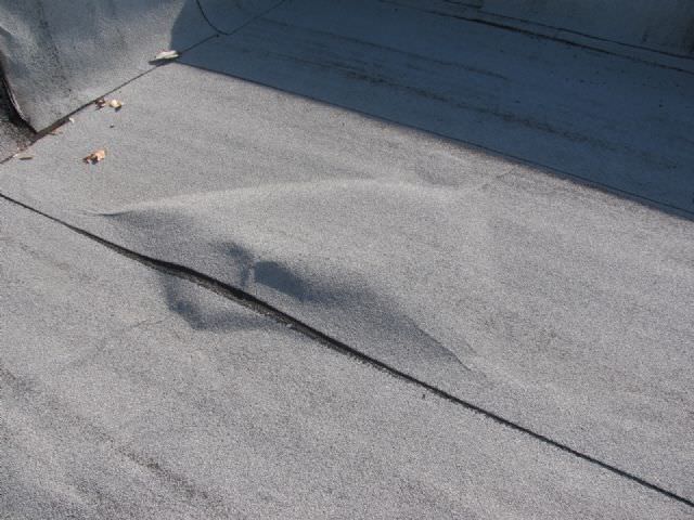

Mark P Posted October 20, 2010 Report Share Posted October 20, 2010 What does the brain recommend about blistering / bubbling of MB? I've read where some recommend slicing them open and re-sealing. I've also read that it is not a problem (assuming there is no active water intrusion) and leave them alone until the roof is replaced. I understand it can be caused for a number of reasons: moisture is getting underneath or it was applied over a wet spot. This is a commercial property. I found no evidence of leaks. Most of the bubbles were the size of the one in the 2nd picture. The one in the 3rd pic was the biggest by far. Click to Enlarge 48.85 KB Click to Enlarge 82.01 KB Click to Enlarge 64.87 KB Link to comment Share on other sites More sharing options...
Bill Kibbel Posted October 20, 2010 Report Share Posted October 20, 2010 Based on the pictures, the only blister needing repair is the one moving a seam. The parapet sucks. I'd tell 'em to replace it but, be sure they don't walk all over the blisters when the work is performed. Link to comment Share on other sites More sharing options...
kurt Posted October 20, 2010 Report Share Posted October 20, 2010 Water will expand approximately 700 times it's volume when it goes from liquid to vapor. It doesn't take much water to create a couple of those blisters. I'd be much more concerned with the parapet, and not just the crappy seams. What's going on under the membrane that's (incorrectly) wrapped up over the coping? In most cases, it's parapetitis. Also, what's the roof structure and sheathing, is there a closed/sealed attic "plenum", what insulation.....(?).... Reason I ask......I've been finding some mightily screwed up roof structure that's got mod bit on top, drywall on the bottom, and insulation stuffed between the two. Link to comment Share on other sites More sharing options...

Marc Posted October 20, 2010 Report Share Posted October 20, 2010 That rectangular area below the scupper looks like a repair. A failure in that area can be expected when such a large amouint of water is dumped on a level roof. It should be piped away to the ground or rainwater drainage system. Also, there's no gravel on that rectangle. Asphalt degrades rapidly when exposed to the UV content of sunlight. Given that it's commercial and a big one, I'd likely punt the entire roof to a Registered Roofing Consultant. Marc Link to comment Share on other sites More sharing options...
