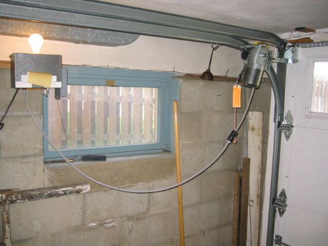

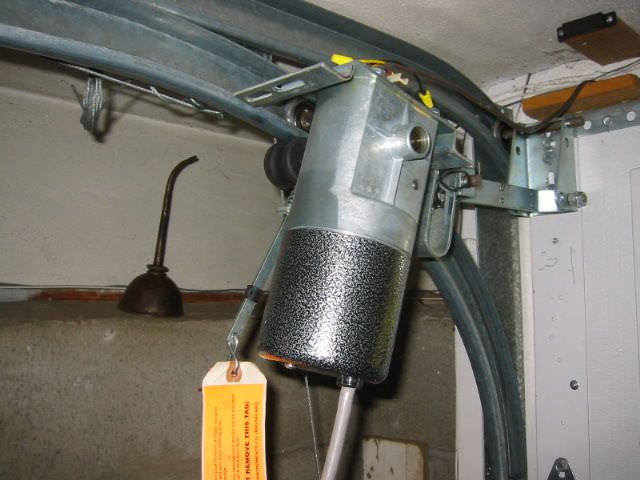

Inspectorjoe Posted October 26, 2010 Report Share Posted October 26, 2010 I don't know how many times I've gone into a basement garage with low overhead clearance to find part of the ceiling cut out (and often the joists deeply notched) to achieve clearance for the door operator rail. After recommending the damage be repaired and the fire separation restored, I have always been at a loss as to what to recommend as a replacement, other than "get used to lifting the door by hand". I ran into this nifty operator today. It requires no overhead clearance. The motor is attached to a modified door roller bracket. Other than starting and stopping rather abruptly, it worked great and had a reversing beam. http://miracleinstrument.goods.officeli ... 20rev1.pdf Click to Enlarge 45.41 KB Click to Enlarge 48.41 KB Quote Link to comment Share on other sites More sharing options...
John Kogel Posted October 27, 2010 Report Share Posted October 27, 2010 I don't know if I'd trust that gizmo. It doesn't pull evenly, so the door will want to jamb. The rubber wheel is going to spin out. Let's wait and see if they stand the test of time. Quote Link to comment Share on other sites More sharing options...
Bill Kibbel Posted October 27, 2010 Report Share Posted October 27, 2010 I don't know if I'd trust that gizmo. It doesn't pull evenly, so the door will want to jamb. The rubber wheel is going to spin out. Let's wait and see if they stand the test of time. That was my first thought - yankin' on a corner. Quote Link to comment Share on other sites More sharing options...
kurt Posted October 27, 2010 Report Share Posted October 27, 2010 On first glance, I'd agree that it's questionable. That said, I've seen a few door openers where overhead clearance was nonexistent, and side pull brackets were installed that opened the door by "pulling on the corner". To my amazed interest, they all worked great. If an overhead door is correctly installed and counterbalanced with torsion springs, pulling on the corner shouldn't torque the door out; its really being lifted by the springs that are pulling equally on both ends of the door with cables attached to the bottom of the door, no? At least, that's how I figured they worked so well. Quote Link to comment Share on other sites More sharing options...
Inspectorjoe Posted October 27, 2010 Author Report Share Posted October 27, 2010 On manually operated doors, where is the pull rope? Attached to a corner bracket. And how about big, heavy commercial doors? Many if not most that I've seen have the lift handles mounted to the side. So I don't think that a properly balanced door is going to suffer any damaging stress from a side mount operator. I've seen a few jerry-rigged side mounts and they seemed to work fine. A few years ago I saw a single operator located between two doors, operating them simultaneously. I wish I could locate the picture. I found a Youtube video of a Miracle operator, apparently uploaded by a proud handy-homeowner. If this guy's mechanical skills are on the same level as his foam-in-a-can application skills, I'd say that just about anybody could install this device. [utube] " type="application/x-shockwave-flash" wmode="transparent" width="425" height="344"> I also ran across a cool German-made operator. It has a fixed chain embedded in the rail that the motor runs along. They make a side-mount option for it. http://www.sommer-usa.com/Garage-Door-Openers_p_10.html http://www.sommer-usa.com/Side-mount-kit_p_28.html Quote Link to comment Share on other sites More sharing options...
inspector57 Posted October 27, 2010 Report Share Posted October 27, 2010 They make a unit that mounts to the wall and operates on the torsion bar that does not look nearly as squirrel as that. Moving the motor with the door looks like something uncle Bubba would come up with after a few too many beers IMHO. http://www.garageheadquarters.com/image ... 4A3268.pdf Quote Link to comment Share on other sites More sharing options...
Tom Raymond Posted October 27, 2010 Report Share Posted October 27, 2010 Jack shaft openers still require at least enough headroom to use a front mounted torsion spring, and that is generally 6". Offsetting the opener is a bad idea on a door with extension springs, with a torsion spring you can place the opener anywhere there is a vertical stile. The only thing I see wrong with this little guy is the power cord. I can imagine all manner of dangerousness happening to it as it swings across the garage. Quote Link to comment Share on other sites More sharing options...
