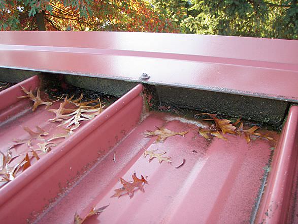

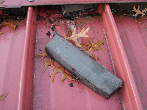

Ken Meyer Posted October 27, 2010 Report Share Posted October 27, 2010 These spongy foam blocks are installed along both sides of a continuous ridge vent. Do they allow for much air flow? It doesn't seem that they would. There is no other roof ventilation, and no attic, this is a small ranch home with vaulted ceilings throughout. The foam blocks are all gunked up with algae. If they are intended to allow for air flow, I think the only way to clean them is to remove every one, clean them, and put them back. Click to Enlarge 61.09 KB Click to Enlarge 49.01 KB Quote Link to comment Share on other sites More sharing options...
kurt Posted October 27, 2010 Report Share Posted October 27, 2010 Never seen such a thing. I don't think there's any way they could allow air flow. How about cutting some of the "brillo pad" stuff used on the ridge vent rolls (cut to size) and stuffing that in there? Quote Link to comment Share on other sites More sharing options...
Marc Posted October 27, 2010 Report Share Posted October 27, 2010 They are not there to provide airflow. Their purpose is to prevent wind driven rain from reaching the top of the panel and ending up where it doesn't belong. My metal panel and standing seam installations have a wide ridge trim and if the pitch is under 4/12, I won't do the job. Don't want my name on all those callbacks. Been there, done that. Marc Quote Link to comment Share on other sites More sharing options...

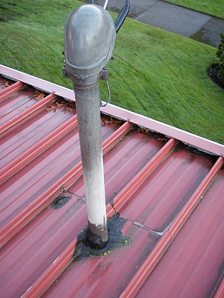

Marc Posted October 27, 2010 Report Share Posted October 27, 2010 Thanks Marc. I can see that happening, not much slope as you can see. Click to Enlarge 77.86 KB Got a problem with that gas vent too, since it's spread across a seam. Skylights should be set back a little from the ridge trim with a short piece of flat flashing running from under the ridge to over the skylight flashing, extending on both sides to the nearest seam. Marc Quote Link to comment Share on other sites More sharing options...

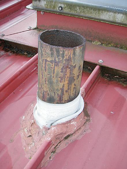

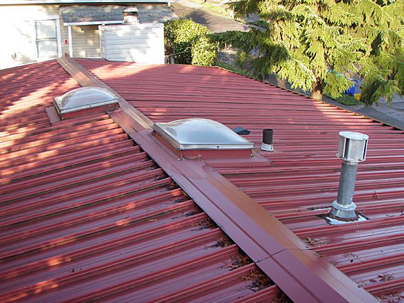

Ken Meyer Posted October 27, 2010 Author Report Share Posted October 27, 2010 That's not the only one. I haven't inspected that many standing seam roofs, but this seems to be a common installation problem. Click to Enlarge 48.71 KB Click to Enlarge 58.19 KB Quote Link to comment Share on other sites More sharing options...
kurt Posted October 27, 2010 Report Share Posted October 27, 2010 Woof....now that I can see the whole thing, it's a mess. Like Marc said, shallow pitch metal roofs are problematic. Those flashing penetrations tell the tale; the installers didn't know what they were doing. Quote Link to comment Share on other sites More sharing options...
David Meiland Posted October 28, 2010 Report Share Posted October 28, 2010 That pitch is way too low, so rain was probably being driven up under the ridge cap and leaking into the house. The correct installation detail is usually to snip and bend the top end of the panel up at 90 degrees, to form a dam, and the ridge cap spans over that. It wouldn't work with that ridge cap profile, but with the correct shapes it can be done and won't leak except during a hurricane, when everything else is leaking too. I would not want that roof on my house. Ideally the various installers work together to make sure the vents and whatnot pop up in the middle of panels, where you can use a dek-tite rubber boot. Hell, it doesn't take much effort, all you have to do is look up from below, find the rows of screws, and drill your hole right between them. Quote Link to comment Share on other sites More sharing options...

mgbinspect Posted October 28, 2010 Report Share Posted October 28, 2010 They are not there to provide airflow. Their purpose is to prevent wind driven rain from reaching the top of the panel and ending up where it doesn't belong. My metal panel and standing seam installations have a wide ridge trim and if the pitch is under 4/12, I won't do the job. Don't want my name on all those callbacks. Been there, done that. Marc What he said. Not a vent. We used to be a representative for Morton Metal buildings. Quote Link to comment Share on other sites More sharing options...
