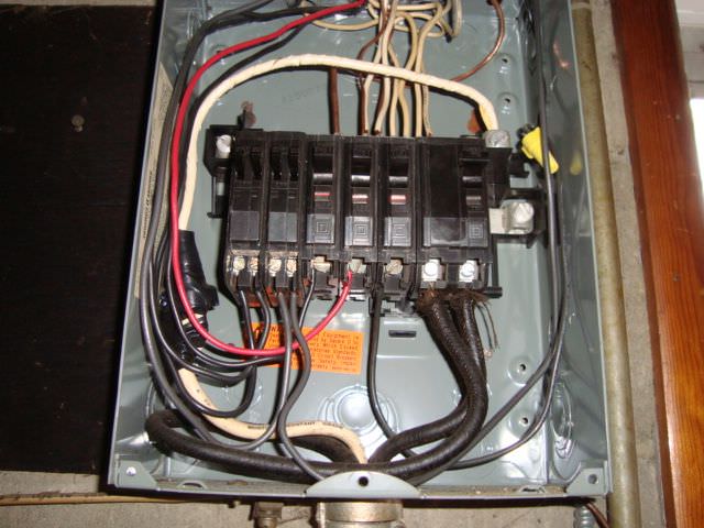

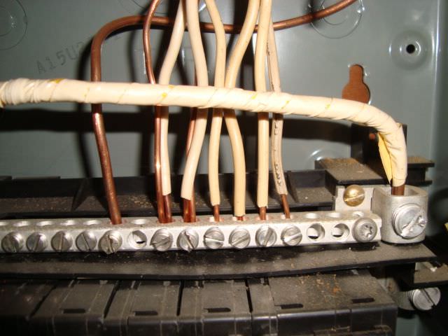

Anatol Posted March 1, 2011 Report Share Posted March 1, 2011 Fellow Inspectors, Today's inspection was a town home with 2 apartments. 100 amp over head service entering home. One panel had the neutral reduced at a splice to #10 before attaching to the neutral buss. I wrote that up as a concern. Comments welcome. Photo is of reduced neutral. Anatol Click to Enlarge 63.39 KB Click to Enlarge 52.83 KB Quote Link to comment Share on other sites More sharing options...
Jim Katen Posted March 2, 2011 Report Share Posted March 2, 2011 Fellow Inspectors, Today's inspection was a town home with 2 apartments. 100 amp over head service entering home. One panel had the neutral reduced at a splice to #10 before attaching to the neutral buss. I wrote that up as a concern. Comments welcome. Photo is of reduced neutral. . . I'm not sure what comments you want. The skinny neutral is wrong. Is the backfed breaker secured in place? Is the equipment supposed to have those two tandems on the left? Do the two sides of the multi-wire circuit originate on different poles? Is this a service panel? If so, where does the GEC go? If not, the neutrals aren't isolated. - Jim Katen, Oregon Quote Link to comment Share on other sites More sharing options...
Marc Posted March 2, 2011 Report Share Posted March 2, 2011 Looks bigger than a #10. It's a lightly taped solid copper conductor. Marc Quote Link to comment Share on other sites More sharing options...
Jim Katen Posted March 2, 2011 Report Share Posted March 2, 2011 Looks bigger than a #10. It's a lightly taped solid copper conductor. Marc I think you're right. Maybe #8. Still wrong. Quote Link to comment Share on other sites More sharing options...
Douglas Hansen Posted March 2, 2011 Report Share Posted March 2, 2011 There is more going on here. The panel is at most 20 - 25 years old. The feeders to it are much older. Why was it changed out, and what else did they do when it was changed out? Was there a fuse panel here and someone needed to add circuits, or "upgrade" to breakers to satisfy an insurance company requirement? Does it look like other equipment or circuits were added at the time this panel was installed? Mark and James are of course correct, and we should ask why someone would wrap white tape around a bare conductor. The splice of the two very different conductors under a wire nut isn't just a case of choosing the wrong connector - it suggests that the person who did it lacked a truck full of parts from which to choose the correct conductor and splice block. In other words, it probably wasn't done by a trained or qualified electrician. What else did you see that has this person's signature level of workmanship? Douglas Hansen Quote Link to comment Share on other sites More sharing options...
Darren Posted March 2, 2011 Report Share Posted March 2, 2011 I know the feeder cables should be approximately the same size (length). In the photo above one is looped around so it's about 8-10 inches longer. Does 'the same length' mean exactly that or is the 8-10 inches OK? Quote Link to comment Share on other sites More sharing options...
Marc Posted March 2, 2011 Report Share Posted March 2, 2011 If they are parallel conductors, yes, but separate...I don't see why they need to be the same length. Maybe this old electrician has forgotten. Marc Quote Link to comment Share on other sites More sharing options...
Jim Katen Posted March 2, 2011 Report Share Posted March 2, 2011 I know the feeder cables should be approximately the same size (length). In the photo above one is looped around so it's about 8-10 inches longer. Does 'the same length' mean exactly that or is the 8-10 inches OK? I'm unaware of the same-length requirement and I can't think of any reason why it would be necessary. I'd expect the conductors to be just the right length without any excess curled up in the box. - Jim Katen, Oregon Quote Link to comment Share on other sites More sharing options...

Anatol Posted March 3, 2011 Author Report Share Posted March 3, 2011 Thanks for the feedback. I did write up the issues you have mentioned. Some where in the back of my mind, I had read that the neutral could be reduced under certain circumstances. I will erase that from memory... Anatol Quote Link to comment Share on other sites More sharing options...
Jim Katen Posted March 3, 2011 Report Share Posted March 3, 2011 Thanks for the feedback. I did write up the issues you have mentioned. Some where in the back of my mind, I had read that the neutral could be reduced under certain circumstances. I will erase that from memory... Perhaps you're remembering that the neutral can be sized smaller than the hot conductors. It's supposed to be sized to carry the maximum unbalanced load between it and either of the hot conductors. That commonly works out being a size or two smaller than the hots. - Jim Katen, Oregon Quote Link to comment Share on other sites More sharing options...
