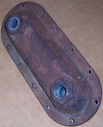

Darren Posted March 5, 2011 Report Share Posted March 5, 2011 Check out this beauty and the size of the TPR. Anyway, the water heater cold water supply is connected to a pipe that exits the Taco multi coil valve? Has anyone ever seen this before? Click to Enlarge 33.84 KB Click to Enlarge 32.81 KB Click to Enlarge 52.07 KB Click to Enlarge 32.99 KB Click to Enlarge 54.49 KB Quote Link to comment Share on other sites More sharing options...
Bill Kibbel Posted March 5, 2011 Report Share Posted March 5, 2011 I've found very similar looking devices on commercial and some large residential boilers. They were heat exchangers for live steam to pre-heat the boiler feed water. I've inspected several large industrial steam boilers used for process equipment that have separate boilers to pre-heat the feed water. Quote Link to comment Share on other sites More sharing options...

Bill Kibbel Posted March 5, 2011 Report Share Posted March 5, 2011 Could that also be called a sidearm water heater? True "Side-arm" water heaters aren't connected to house heating boilers. I've always seen heat exchangers for domestic hot water on steam boilers that look like this: Click to Enlarge 23.63 KB Quote Link to comment Share on other sites More sharing options...
