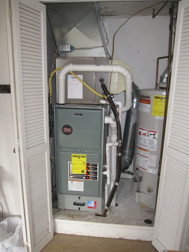

dtontarski Posted April 3, 2011 Report Share Posted April 3, 2011 I have never seen a direct vent furnace venting downhill like this. I reviewed the Ruud Installation Manual and didn't find where they specifically ruled this out, but in reviewing a few other direct vent appliance manuals, I saw wording such as "vent piping cannot under any circumstances be run downhill". And oh yes..this is installed in a bedroom closet with louvered doors right next to a CAT 1 water heater and as vented the furnace is not obtaining all combustion air from the exterior. Does anyone know if a downhill vent run like this is ever acceptable? Click to Enlarge 82.52 KB Quote Link to comment Share on other sites More sharing options...
Terence McCann Posted April 3, 2011 Report Share Posted April 3, 2011 You can't have a hot water heater in a bedroom closet. The furnace seems to be getting it's combustion air from the outdoors by the looks of the piping. I see you've looked through the installations instructions - on the job site or via the internet? If you've found them over the net do you have a link? I'd like to see them. Quote Link to comment Share on other sites More sharing options...
dtontarski Posted April 3, 2011 Author Report Share Posted April 3, 2011 Hi Terry - Yes, I wrote up the water heater in the bedroom closet issue, and I found the manual online for this furnace. Like I said, Ruud didn't have a diagram that illustrated a downhill vent install, but then again, I did not find where they specifically spelled it out that is wasn't allowed like some of the other manufacturers. Have you (anyone?) ever seen a downhill vent install on a direct vent appliance? I've already recommended further evaluation by an HVAC professional on this entire set-up, I'm just trying to learn more about this. Thanks. Quote Link to comment Share on other sites More sharing options...
Terence McCann Posted April 3, 2011 Report Share Posted April 3, 2011 Have you (anyone?) ever seen a downhill vent install on a direct vent appliance? I haven't. However the more I think things are standard the more I find out that they aren't If you go to "new files" on this web site I u/l a Trane installation manual not to long ago. I tried to u/l the Carrier manual as well but it was over the u/l size limit. Do you have a link for the manual? Quote Link to comment Share on other sites More sharing options...
Bill Kibbel Posted April 3, 2011 Report Share Posted April 3, 2011 All Ruud installation instructions I have read, including the two I have here in a file state: "All horizontal piping must slope upward a minimum of 1/4 inch per foot of run so that condensate drains toward the furnace". In your pictured installation, I am assuming the vent that extends through the floor below the furnace will transition to horizontal before exiting a wall. That section of horizontal pipe can't possibly ensure "that condensate drains toward the furnace". Quote Link to comment Share on other sites More sharing options...
dtontarski Posted April 3, 2011 Author Report Share Posted April 3, 2011 Thanks - it appears that the 1/4" per ft. pitch upwards is pretty standard, and without any other mention of pitch, that if any section of the exhaust vent does not have that pitch...then I can justify calling it out. I guess I just like having things spelled out, and because this was called out on another manufacturer's site, it made me wonder about it. But like Terry says....the more you think (assume) things are standard, the more you find out that they are not. Other: This vent did run horizontally within a crawlspace....the access to which was entirely obstructed by the current owner's stuff....I volunteered to come back and inspect the crawlspace once the bobcat cleared me a path. Quote Link to comment Share on other sites More sharing options...

inspectorreuben Posted April 4, 2011 Report Share Posted April 4, 2011 I wouldn't worry about the vent going up or down, as long as it does one of the two and condensation doesn't discharge to an objectionable location. The manufacturers just don't want there to be a place in the vent where the condensate will collect. - Reuben Quote Link to comment Share on other sites More sharing options...

dtontarski Posted April 5, 2011 Author Report Share Posted April 5, 2011 My post got off track, but I guess that was my fault for providing too much information in my original post. (good dialogue though) Here's an update: Ruud was no help, but I was able to speak to someone at Rheem (Arkansas), and he verified that this was wrong and cited their 1/4" per ft. pitch upwards rule for all horizontal pipes as the documentation for citing this as disallowed. (Like Bill Kibbel pointed out) And.....he requested photos of the install, and had already spoken to someone else in the organization about this. Perhaps someday soon we might see the Ruud/Rheem install manuals call this out more clearly, as some other manufacturers of direct vent appliances are currently doing. (kind of like McDonalds having to tell people their coffee is hot, but who knows it might actually prevent a mishap someday) Quote Link to comment Share on other sites More sharing options...
