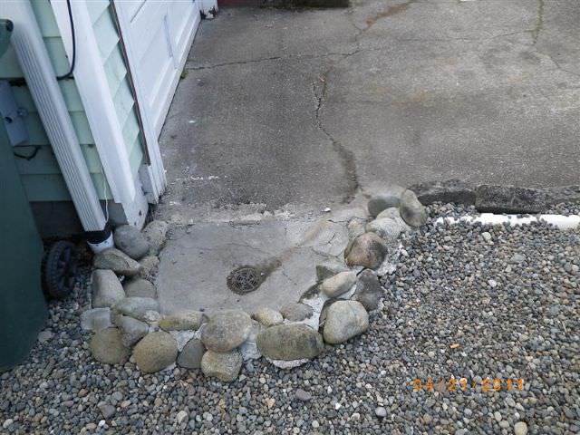

Robert Jones Posted April 22, 2011 Report Share Posted April 22, 2011 I am being told that there is a sump pump installed in this drain area. There are two cables feeding the area, so I am guessing they are correct. The only thing I see running to it, is the back left corner downspout! WTF! Click to Enlarge 65.42 KB Click to Enlarge 74.06 KB Click to Enlarge 79.68 KB Quote Link to comment Share on other sites More sharing options...
hausdok Posted April 22, 2011 Report Share Posted April 22, 2011 Hi Robert, I've seen a few of those. Most of the time they are in a nasty hole dug in the ground that's lined with plywood or something else that's eventually going to cave in, and they usually don't have anti-backflow valves on them and are pretty jack legged. I saw one though that was nicely placed at the bottom of a crib built from CMU's stacked in a circle and mortared up. The pump was solidly stabilized by being clamped to a piece of rebar that spanned the well and the whole arrangement had been wrapped with geo-textile fabric and was surrounded by a 1ft. thick layer of quarter stone that was also wrapped with GT fabric. The cable feeding it went below grade in conduit and was GFCI protected and they had a nice pre-cast reinforced concrete lid on the thing with rebar handles cast into it. It was too heavy for a kid to lift but with a little effort I was able to swing it out of the way to inspect it without throwing my back out. Unless you can see it and know how it's been installed, just say that it's inaccessible for inspection and is excluded from the scope of the inspection per WAC 308-408C-030(1)(12) and WAC 308-408C-100(2)(b)(ii). ONE TEAM - ONE FIGHT!!! Mike Quote Link to comment Share on other sites More sharing options...
