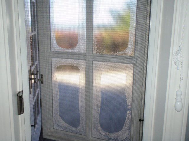

inspectorwill Posted May 5, 2011 Report Share Posted May 5, 2011 Discoloration and modeling visible at the laminated glass. Anyone know the cause and if there is terminology to describe it to my client? Thanks Click to Enlarge 53.16 KB Click to Enlarge 40.25 KB Quote Link to comment Share on other sites More sharing options...
mgbinspect Posted May 5, 2011 Report Share Posted May 5, 2011 I don't know if this will be helpful or not, but I know for a fact that when you see that happening on mirrors (laminations coming apart). It's from cleaning with chlorine based cleaners. (I always wondered what made mirrors get all screwed up on the outer edges. Then, my youngest son surprised me by cleaning the bathroom. Twenty-four hours later my mirror was toast. He had used chlorine based tub and tile cleaner on the mirror, and that did it in. Apparently, whatever is used in the lamination process can't tolerate chlorine.) Quote Link to comment Share on other sites More sharing options...
Tom Raymond Posted May 5, 2011 Report Share Posted May 5, 2011 It's delaminated. It will no longer function as intended. When it breaks The delaminated portion will not remain in place, and if the impact is hard enough it may all fall out. It has failed and should be replaced. Quote Link to comment Share on other sites More sharing options...
caryseidner Posted May 5, 2011 Report Share Posted May 5, 2011 That 2nd photo really looks like an aftermarket window film to me. Any chance it is? Quote Link to comment Share on other sites More sharing options...
Scottpat Posted May 5, 2011 Report Share Posted May 5, 2011 I have never seen laminated glass in a residental window or door. I agree it looks like window tint that has gone bad. Modeling? I don't think that word corresponds to what is in the picture. Quote Link to comment Share on other sites More sharing options...
Jim Katen Posted May 6, 2011 Report Share Posted May 6, 2011 The first one looks like solvent damage. Perhaps someone used a chemical paint stripper on the muntins? The second one looks familiar. The same thing happened to the windshield of my 1970 F100. It was like that when I got it in '84 and it was still like that when I traded it in '01. As far as I could tell, it never changed in all that time. Quote Link to comment Share on other sites More sharing options...
John Kogel Posted May 6, 2011 Report Share Posted May 6, 2011 The first one looks like solvent damage. Perhaps someone used a chemical paint stripper on the muntins? The second one looks familiar. The same thing happened to the windshield of my 1970 F100. It was like that when I got it in '84 and it was still like that when I traded it in '01. As far as I could tell, it never changed in all that time. You got kind of attached to that beast, huh Jim? I think the word is 'mottled'. Quote Link to comment Share on other sites More sharing options...
