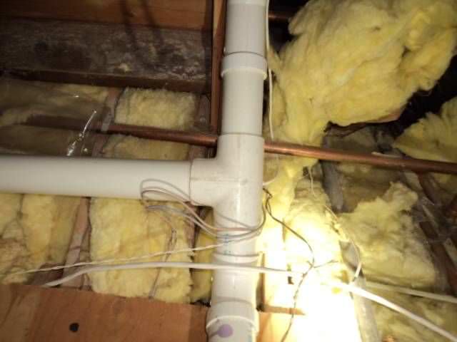

Neal Lewis Posted May 22, 2011 Report Share Posted May 22, 2011 Just verify for me that this fitting is wrong for this vent piping in the attic. Should be a sanitary tee? Thanks Click to Enlarge 37.94 KB Quote Link to comment Share on other sites More sharing options...
mgbinspect Posted May 22, 2011 Report Share Posted May 22, 2011 In all honesty, once it gets to the vent side, I'm. Just happy if there is one, and don't sweat much other than that. But, that's just me. Quote Link to comment Share on other sites More sharing options...
ericwlewis Posted May 22, 2011 Report Share Posted May 22, 2011 looks like a handyman add on. I would be curious where it goes to/ comes from. Quote Link to comment Share on other sites More sharing options...
plummen Posted June 16, 2011 Report Share Posted June 16, 2011 Should have used a san tee or a wye Quote Link to comment Share on other sites More sharing options...
Jim Katen Posted June 17, 2011 Report Share Posted June 17, 2011 Just verify for me that this fitting is wrong for this vent piping in the attic. Should be a sanitary tee? Thanks It's wrong. A sanitary tee would have a built-in angle that would help the vent line to drain properly. Vent shouldn't be horizontal any more than drain lines should. Quote Link to comment Share on other sites More sharing options...
Jim Morrison Posted June 17, 2011 Report Share Posted June 17, 2011 I've considered this issue thoughtfully for more than a day and while I fully concede that it's (lower case w) wrong, I can't imagine a world in which I'd devote more than about 45 seconds to the entire affair. I think that it's worth noting, but not worth fixing. Good call, Neal. Quote Link to comment Share on other sites More sharing options...
