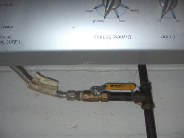

allseason Posted June 17, 2011 Report Share Posted June 17, 2011 Can this ball valve be used on a gas line? On the Watts web site it says it is used for a full range of liquids and gases but there gas valves have a distinctly different handle. Click to Enlarge 32.17 KB Quote Link to comment Share on other sites More sharing options...
allseason Posted June 17, 2011 Author Report Share Posted June 17, 2011 Just heard from Watts, that valve is UL approved for Natural Gas. Quote Link to comment Share on other sites More sharing options...
Terence McCann Posted June 17, 2011 Report Share Posted June 17, 2011 Just heard from Watts, that valve is UL approved for Natural Gas. Me too. Quote Link to comment Share on other sites More sharing options...

Neal Lewis Posted June 18, 2011 Report Share Posted June 18, 2011 Chris, this is what I was told years ago; probably read it here. On the brass body of the valve will be printed WOG, which stands for water, oil, gas. Approved for all three. BTW, Annmarie told me you spoke to her at the bank. Sorry to hear biz isn't good. We're crazy busy. Quote Link to comment Share on other sites More sharing options...
Jim Katen Posted June 18, 2011 Report Share Posted June 18, 2011 Chris, this is what I was told years ago; probably read it here. On the brass body of the valve will be printed WOG, which stands for water, oil, gas. Approved for all three. The last time I got involved in a discussion about valves and their WOG rating, it got exceedingly confusing and complicated. I don't remember most of it, but what I took away is that WOG does *not* indicate that the valve is necessarily combatible with water, oil, & gas. Rather, the WOG rating is the pressure that the valve can be exposed to when used with water, oil, or gas. (As opposed to steam.) If anyone actually knows how this works, I'd love to have a refresher on it. Quote Link to comment Share on other sites More sharing options...
