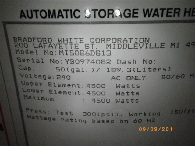

Robert Jones Posted September 10, 2011 Report Share Posted September 10, 2011 My first Crosley manufactured water heater. Is 2009 the correct age? Click to Enlarge 43.92 KB Click to Enlarge 57.48 KB Quote Link to comment Share on other sites More sharing options...
Richard Moore Posted September 10, 2011 Report Share Posted September 10, 2011 I've never run across one labeled as a Crosley, but your first photo shows Bradford White as the manufacturer and I would expect the serial number to conform to their table. YB would be February, 2002. Quote Link to comment Share on other sites More sharing options...
hspinnler Posted September 10, 2011 Report Share Posted September 10, 2011 It's manufactured by Bradford White and you will find the date and year in the first two letters of the S/N: February 2002. See the following link: http://www.bradfordwhite.com/findaserial.asp Quote Link to comment Share on other sites More sharing options...
Garet Posted September 10, 2011 Report Share Posted September 10, 2011 What was the date of the ANSI standard? It's cut off in your first picture. ANSI standards are updated every 3-4 years, which would confirm the difference between 2002 and 2009. Quote Link to comment Share on other sites More sharing options...
