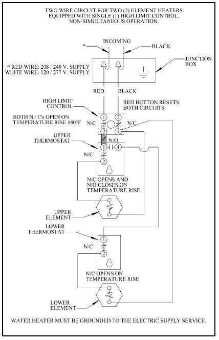

rkenney Posted January 13, 2012 Report Share Posted January 13, 2012 For the symptoms you describe, the top element is the wrong element to replace. The top element heats the top third or so of the water. When the temperature setting is reached by the upper thermostat it turns off the top element and turns on the bottom element. When cold water comes in at the bottom of the tank the bottom element comes on but will shutoff if the top thermostat reaches its turn-on temperature (because you drew a lot of hot water), at which point the top element heats and then turns it over to the bottom element when the upper thermostat is satisfied. Both elements are never on at the same time. If the top element were bad, the thermostat (upper) would never turn on the bottom element. You might as well just flip the breakers off. Quote Link to comment Share on other sites More sharing options...
Marc Posted January 13, 2012 Report Share Posted January 13, 2012 If the top element were bad, the thermostat (upper) would never turn on the bottom element. Not quite. Download Attachment: waterheaterwiringdiagram.jpg 102.33 KB There are three thermostats. They each actuate on a temperature rise. The high limit thermostat removes power from both lower thermostats when a defect has allowed the water temperature to reach the max design temp of the appliance. This resettable thermostat isn't field adjustable but is set by the factory. The two lower thermostats are each paired with a heating element and have a normally closed (NC) contact that energizes that respective element until the water temperature arrives at the preset value, whatever that is. To prevent both elements from becoming energized at the same time, the middle thermostat has an additional pole, this one a normally open (NO), that removes power from the lower thermostat whenever the upper thermostat is actuated. The appliance isn't intended to power both elements at the same time. Marc Quote Link to comment Share on other sites More sharing options...

rkenney Posted January 13, 2012 Report Share Posted January 13, 2012 So, what is "not quite" here? The 'high limit switch' is merely a safety disconnect and has nothing to do with normal operation. If it was open you would have no hot water. They don't want to know how to build a watch. If the upper thermostat is not temperature satisfied (hot) the lower element will never come on. If it (upper element) is open or not heating adequately the lower element will not come on. The OP has hot water for five minutes. So it can not be the upper element. Has to be the lower element or more likely a broken dip tube. Replacing the upper element will not solve the problem. Quote Link to comment Share on other sites More sharing options...
Marc Posted January 13, 2012 Report Share Posted January 13, 2012 My bad. After re-reading, I see where you were correct in asserting that a defective upper element would prevent both elements from becoming energized. Marc Quote Link to comment Share on other sites More sharing options...
