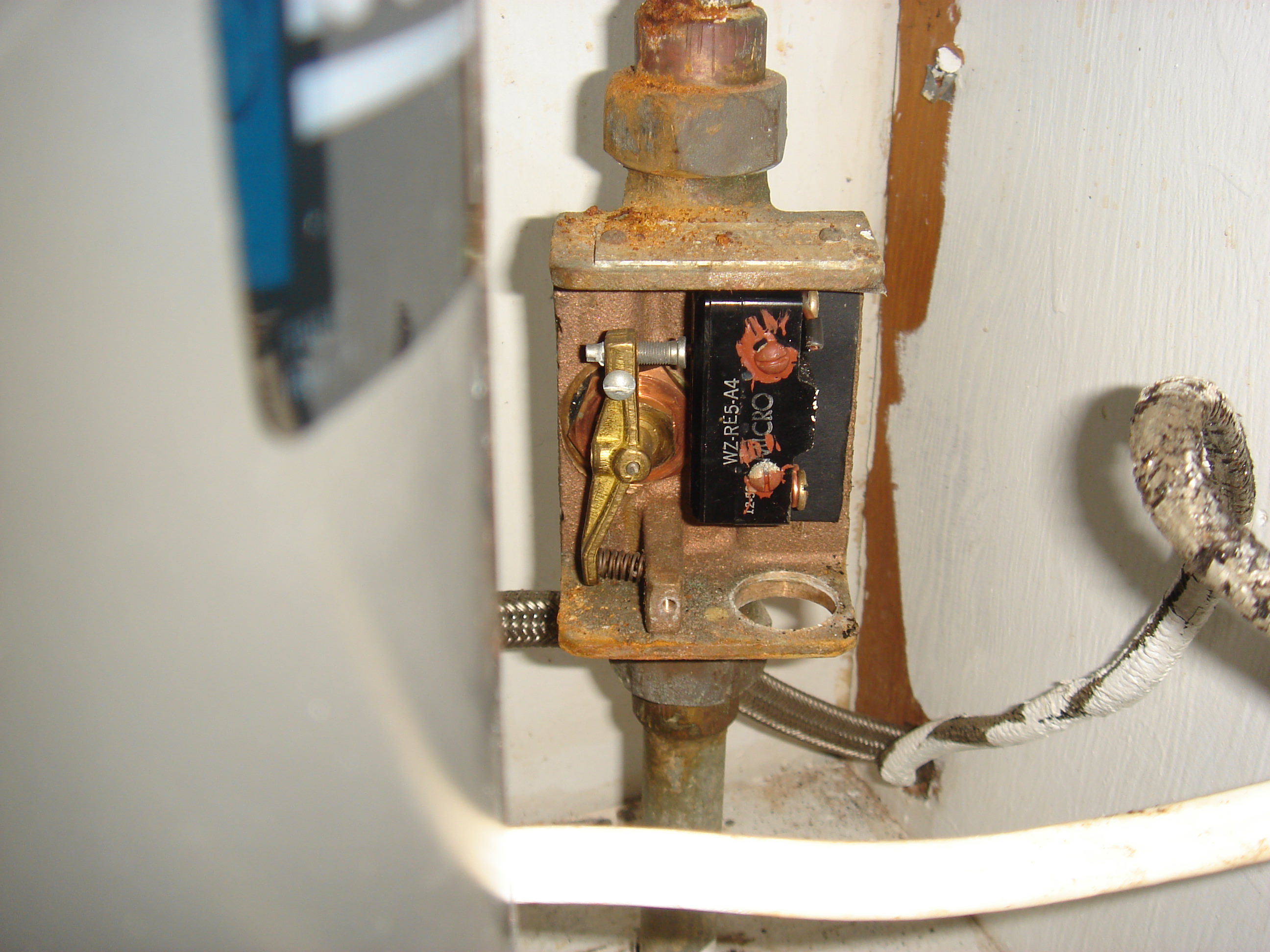

Bain Posted February 9, 2012 Report Share Posted February 9, 2012 Kevin posted a photo of one of these gizmos recently, and I found another today. Mine was disconnected from its power source, and its cover had been removed. I realize the purpose of the thing is to prevent the disposal from operating unless water is running. But I'm not sure about the exact process. Apparently the spring on the bottom of the rocker arm maintains a connection between the adjustable screw-contact on the upper portion of the rocker arm and the contact on the wiring box. When water is run, I'm assuming there's a little impeller in the pipe that overcomes the tension of the spring, separates the contacts, and somehow makes the electrical connection. I'm curious, though. What actually happens when the contacts between the upper rocker arm and the box containing the wiring screws are separated? By what process does that allow current to flow? Download Attachment: DSC06407.JPG 1984.76 KB Quote Link to comment Share on other sites More sharing options...
AHI in AR Posted February 9, 2012 Report Share Posted February 9, 2012 It looks to me like that rocker arm assembly operates the micro switch itself. The rocker arm is not an electrical contact. I suspect that the microswitch is normally open, and when water flows and the rocker arm moves away from the microswitch the circuit closes, feeding power to the wall switch. Quote Link to comment Share on other sites More sharing options...
rkenney Posted February 9, 2012 Report Share Posted February 9, 2012 It looks to me like that rocker arm assembly operates the micro switch itself. The rocker arm is not an electrical contact. I suspect that the microswitch is normally open, and when water flows and the rocker arm moves away from the microswitch the circuit closes, feeding power to the wall switch. You mean the switch is normally closed. The arm is holding it open. When water flows the arm moves and the switch returns to its normally closed state. Quote Link to comment Share on other sites More sharing options...
AHI in AR Posted February 10, 2012 Report Share Posted February 10, 2012 Electrically speaking, you are correct -- without the rocker arm as part of the equation the switch would normally be closed. But by "normally" open I meant "when no one is at the sink, water isn't flowing and the rocker arm is pressing against the switch." Quote Link to comment Share on other sites More sharing options...
Chad Fabry Posted February 10, 2012 Report Share Posted February 10, 2012 I doubt there's an impeller- more like a vane or cup on an eccentric mount. Quote Link to comment Share on other sites More sharing options...
