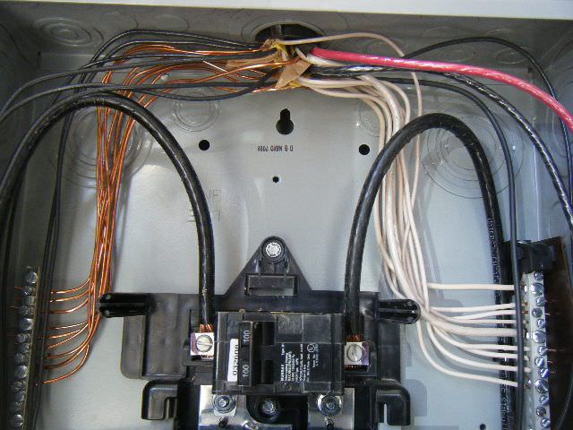

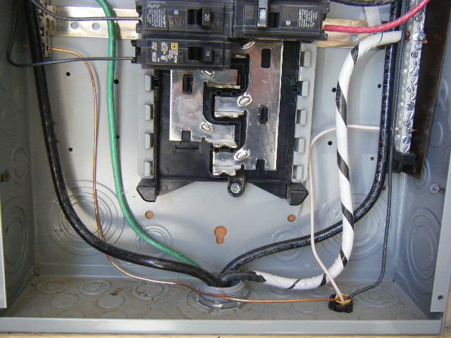

Denray Posted March 27, 2012 Report Share Posted March 27, 2012 Shouldn't there be a grounding electrode conductor in this sub panel? Click to Enlarge 67.59 KB Click to Enlarge 77 KB It's in a separate RV garage. Click to Enlarge 66.23 KB Quote Link to comment Share on other sites More sharing options...
Jim Katen Posted March 27, 2012 Report Share Posted March 27, 2012 Yes. And a grounding electrode. Quote Link to comment Share on other sites More sharing options...
Denray Posted March 27, 2012 Author Report Share Posted March 27, 2012 Thanks Jim. It was my first real fancy house and I called it. Just making sure. Didn't want the client or agents coming back at me proving me a dumbtard. Quote Link to comment Share on other sites More sharing options...
Jim Katen Posted March 27, 2012 Report Share Posted March 27, 2012 If they come back, cite NEC 250.32(A). 250.32 Buildings or Structures Supplied by a Feeder(s) or Branch Circuit(s). (A) Grounding Electrode. Building(s) or structure(s) supplied by feeder(s) or branch circuit(s)shall have a grounding electrode or grounding electrode system installed in accordance with Part III of Article 250. The grounding electrode conductor(s) shall be connected in accordance with 250.32(B) or ©. Where there is no existing grounding electrode, the grounding electrode(s) required in 250.50 shall be installed. Quote Link to comment Share on other sites More sharing options...
Garet Posted March 28, 2012 Report Share Posted March 28, 2012 Are the EGC bar and the neutral bar separated? Quote Link to comment Share on other sites More sharing options...
Jim Port Posted March 28, 2012 Report Share Posted March 28, 2012 The bond strap is hanging loose on the right hand side. Quote Link to comment Share on other sites More sharing options...
Garet Posted March 29, 2012 Report Share Posted March 29, 2012 The bond strap is hanging loose on the right hand side. Thanks. I was looking at the 3rd picture, not the 2nd (where it's quite evident). I'm used to seeing that connector bar go all the way from the grounding terminal to the neutral terminal. It's a problem (in any profession) when we see what we expect to see, not what's actually there. Quote Link to comment Share on other sites More sharing options...
