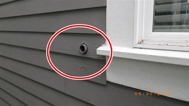

Robert Jones Posted May 31, 2012 Report Share Posted May 31, 2012 Looking for a vent stack code for these two beauties. One is associated with the kitchen and the other the laundry room. Home built in the late 1800's and recently "remodeled". Not sure why they didn't run it up and through the roof during the "remodel" when the walls were open but... Click to Enlarge 31.64 KB Click to Enlarge 46.69 KB Link to comment Share on other sites More sharing options...
Mike Lamb Posted May 31, 2012 Report Share Posted May 31, 2012 IRC P3103.5 Location of vent terminal. An open vent terminal from a drainage system shall not be located less than 4 feet (1219 mm) directly beneath any door, openable window, or other air intake opening of the building or of an adjacent building, nor shall any such vent terminal be within 10 feet (3048 mm) horizontally of such an opening unless it is at least 2 feet (610 mm) above the top of such opening. Link to comment Share on other sites More sharing options...
Jim Katen Posted May 31, 2012 Report Share Posted May 31, 2012 They also slope in the wrong direction. I'd be interested to see what fittings were used. Something is very wrong there. Link to comment Share on other sites More sharing options...
Brandon Whitmore Posted June 1, 2012 Report Share Posted June 1, 2012 Robert, how positive are you that these are vents? Did you see the pipes running through from the interior? Link to comment Share on other sites More sharing options...
Robert Jones Posted June 2, 2012 Author Report Share Posted June 2, 2012 I couldn't get behind the washing machine/dryer stack but, there was no visible vent stack from the roof. This was an addition which had a different roof than the main home, no stack visible. On the main home, where the kitchen is located, the sewer stacks vent up on the outside of the home on the opposite side of the home from the kitchen. Old school cast iron type stacks. At first I thought that the pipe may be for the dishwasher(air gap), but again, I didn't see a vent stack through the roof or running up the side of the home. Link to comment Share on other sites More sharing options...
