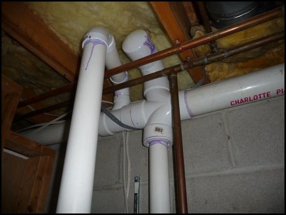

John Dirks Jr Posted September 2, 2012 Report Share Posted September 2, 2012 The picture shows discharge and vent pipes of an ejector pump that serves a basement bathroom. The ejector discharge pipe is the one on the right. I know that is incorrect since it goes into the bottom of the main drain line. That main drain line serves in upstairs hall bathroom including toilet shower and sink. The line on the left from the ejector pump is the vent which loops into the top of the main drain line. My question is this. Is it acceptable to wet vent an ejector pump such as what was done in this picture? Again, I know the discharge line is wrong and that's getting written up. Click to Enlarge 37.4 KB Link to comment Share on other sites More sharing options...
kurt Posted September 3, 2012 Report Share Posted September 3, 2012 No, there should be a 2" branch vent from the ejector eventually venting to the exterior. Link to comment Share on other sites More sharing options...
ericwlewis Posted September 3, 2012 Report Share Posted September 3, 2012 That's a good question. It all looks jack-leg to me. wouldn't the pump be working against itself with this configuration? Link to comment Share on other sites More sharing options...
Scottpat Posted September 3, 2012 Report Share Posted September 3, 2012 Did you see a real vent line or is it just the pseudo vent line from the grinder pump? I would not even call that setup a "wet vent". Link to comment Share on other sites More sharing options...
kurt Posted September 3, 2012 Report Share Posted September 3, 2012 Neither would I. It's a total bollix job. It should all come out. Link to comment Share on other sites More sharing options...
