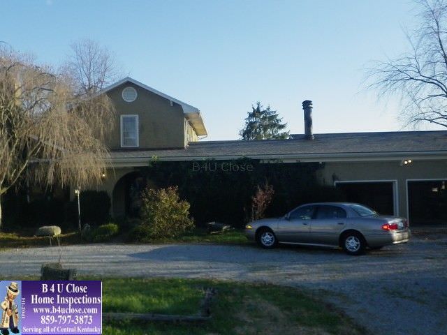

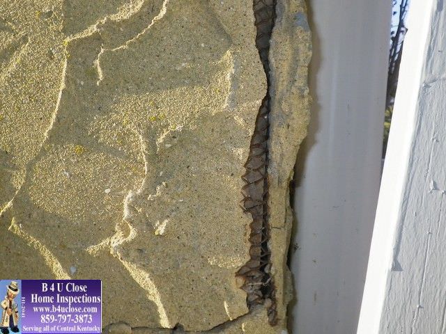

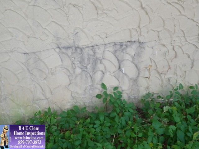

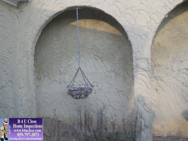

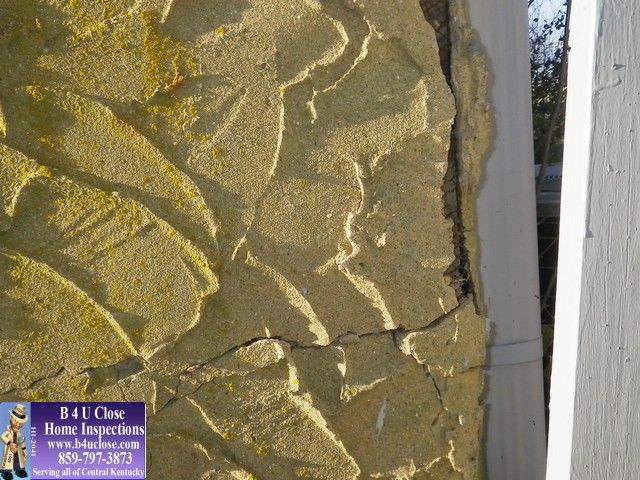

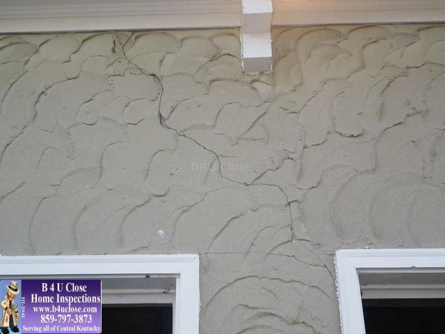

Erby Posted November 24, 2012 Report Share Posted November 24, 2012 I don't see much stucco around here. Any pointers on what to tell the client other than get a stucco inspector. Click to Enlarge 52.96 KB Click to Enlarge 53.36 KB Click to Enlarge 43.7 KB Click to Enlarge 53.36 KB Click to Enlarge 91 KB Click to Enlarge 79.77 KB Click to Enlarge 64.64 KB Click to Enlarge 53.64 KB Link to comment Share on other sites More sharing options...

Marc Posted November 24, 2012 Report Share Posted November 24, 2012 I'd use language along these lines and skip the recommendation for a stucco inspector. I didn't see any expansion joints in the stucco. They're needed when you use cladding as unforgiving to movement/deflection as stucco. The cracks prove that the marriage between the stucco and the structure has failed. Remove it all then either do it over the way the product manufacturer recommends or choose a different type of cladding. Leaving it as is invites expensive moisture intrusion issues later. Don't need to hire a stucco inspector to tell the buyer what you already know. Marc Link to comment Share on other sites More sharing options...
John Kogel Posted November 24, 2012 Report Share Posted November 24, 2012 I think it depends on the age of the house to some extent. Younger than 15 years or so, I'd be inclined to condemn the work more. For an older house, some cracks are to be expected and there are good repair people here in my area. Maybe not so much in Kentucky. I would certainly call for repairs, with a warning that there could be hidden damage to the sheathing and structure, depending on exposure to the elements. Link to comment Share on other sites More sharing options...
Douglas Hansen Posted November 24, 2012 Report Share Posted November 24, 2012 We have lots of stucco here, and have been using it for close to 100 years. Of the thousands of buildings I've looked at with hardcoat stucco, I can't recall one that was quite as FUBAR as yours. The texture they were attempting is called a trowel sweep. It is supposed to be applied in two layers over the base coat, and be troweled in such a way as to leave a narrow ridge or bead at the edges of the fan shapes; whoever did this applied it way too thick and I can't imagine that any of the curing times or conditions were correct. The only good news is that the staining below the horizontal crack indicates water emerging from it, which implies there is some sort of WRB behind this mess. I wouldn't go so far as to bet on flashings. Perhaps when they tear it off the walls they won't be completely damaged. Link to comment Share on other sites More sharing options...

hausdok Posted November 24, 2012 Report Share Posted November 24, 2012 Hi, It's pretty bad; you don't have any accessory beads or expansion joints anywhere and you can see where the expanding stucco has pushed the trim. I've inspected plenty of houses with old type stucco applications that go all the way to the ground - down the framing and wall and over/onto the foundation. Lots have that horizontal crack like in photo #2 and when I get underneath in the crawlspace I find where water backed up behind the stucco because there's no drainage plane at the stucco-to-foundation transition has overflowed the foundation beneath the sill into the interior of the foundation - usually causing substantial rot. ONE TEAM - ONE FIGHT!!! Mike Link to comment Share on other sites More sharing options...
