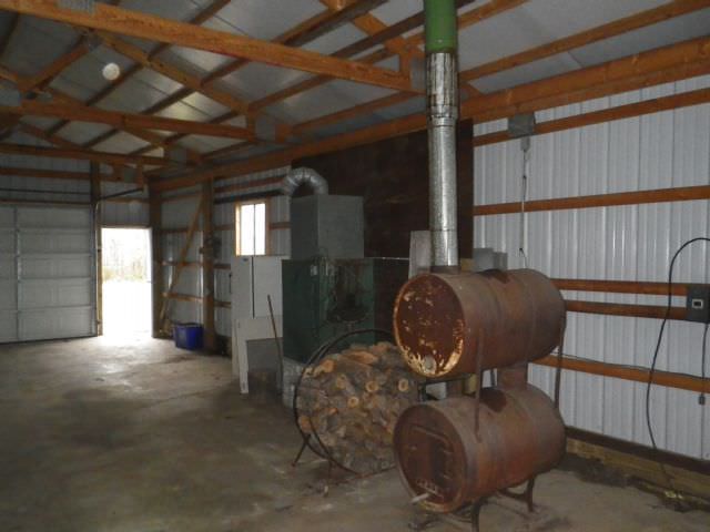

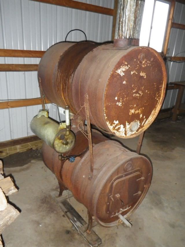

Mark P Posted December 17, 2012 Report Share Posted December 17, 2012 Found this in a large workshop / garage. Not sure how it worked, it seems to be a wood burning stove but also used fuel oil... Click to Enlarge 43.02 KB Click to Enlarge 78.82 KB Click to Enlarge 50.84 KB Link to comment Share on other sites More sharing options...
Chad Fabry Posted December 17, 2012 Report Share Posted December 17, 2012 I've built a few of those over the years. I made mine from scratch but you can buy a kit with the doors and feet. The bottom drum is the firebox, the top drum is just additional surface area to radiate heat. The waste oil drip on a hot bed of coals can provide a lot of heat and it's really low tech. Just don't forget to turn it off. The clearances in the photo are about right- anything closer than three feet or so will burst into flames. Link to comment Share on other sites More sharing options...
kurt Posted December 18, 2012 Report Share Posted December 18, 2012 Those things make great shop heaters. You can stuff huge chunks of wood in them. Once you get them going, the wast oil drip, while environmentally offensive, blasted heat and was the wasted dump of choice for those of us that lived before retail oil change stores. I used to take planer waste (mountains of shavings), pack them tightly into plain brown grocery bags, and burn them; they actually put out an amazing amount of heat with the oil drip. I heated a completely uninsulated metal sided pole barn, about 1200sf, to T shirt comfort in the middle of harsh Michigan winters. We ordered the kits out of Mother Earth News; they probably still have them. I think they were called "Sotz Kits" after the mfg. Link to comment Share on other sites More sharing options...
Jim Baird Posted December 18, 2012 Report Share Posted December 18, 2012 Worked in a cabinet shop in the fierce winter of '77 where shop waste fed one of those, sans oil. Big mistake I made one day was to try stoking it with an air hose with blower attachment. Nearly exploded the whole thing. Link to comment Share on other sites More sharing options...
John Kogel Posted December 18, 2012 Report Share Posted December 18, 2012 Jim, maybe you blew unburned vapor into the top barrel? Ka-boom! When I worked at the garage, the barrel stove used to belch huge plumes of toxic black smoke. Link to comment Share on other sites More sharing options...
