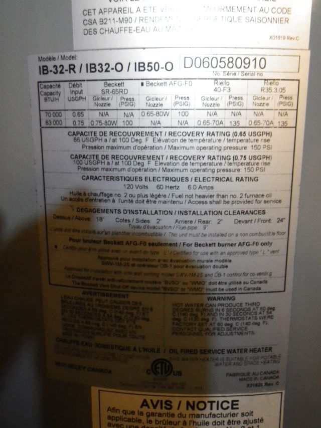

Stephen Lagueux Posted March 21, 2013 Report Share Posted March 21, 2013 Any idea how to get the age of a Brock oil fired water heater? here's a pic of the label with serial number. Click to Enlarge 82.9 KB Click to Enlarge 59.97 KB Quote Link to comment Share on other sites More sharing options...
Bill Kibbel Posted March 21, 2013 Report Share Posted March 21, 2013 Single letter, month, year. June 2005. You can confirm it with the date on the oil burner and/or relief valve handle. Quote Link to comment Share on other sites More sharing options...
