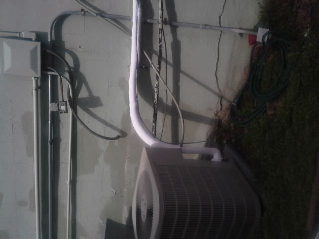

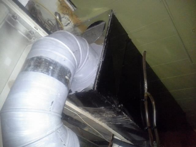

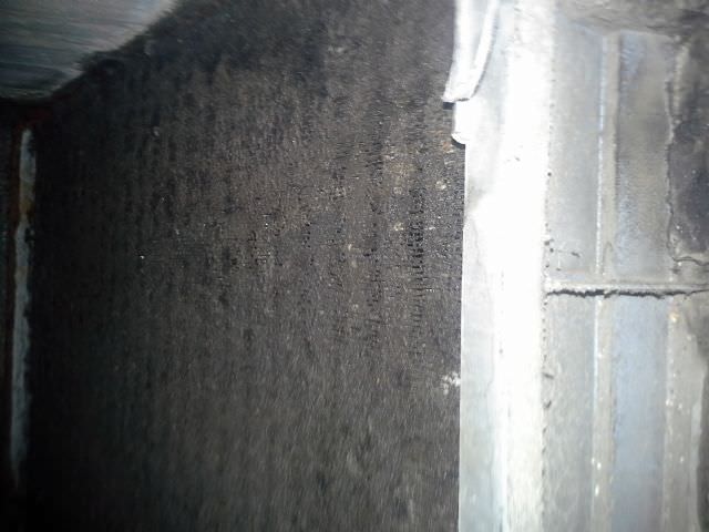

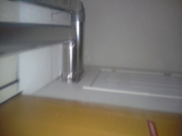

plummen Posted April 25, 2013 Report Share Posted April 25, 2013 Click to Enlarge 33.16 KB Click to Enlarge 21.87 KB Click to Enlarge 44.39 KB The one on the left side above door was my temp install What happened to rest of my post? This was my temp fix for a craigslist handyman butch job,Once I get the new cold air return built Ill post a picture. Basically the hack artist decided it didn't matter that the coil was completely plugged,and he thought his 8" cold air return was enough for that 3t condenser and air handler. I was outside looking at an electrical project when I noticed the iced up lineset/compressor that they failed to notice after their install.[:-censore Quote Link to comment Share on other sites More sharing options...
