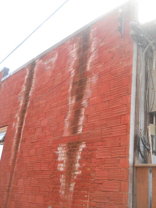

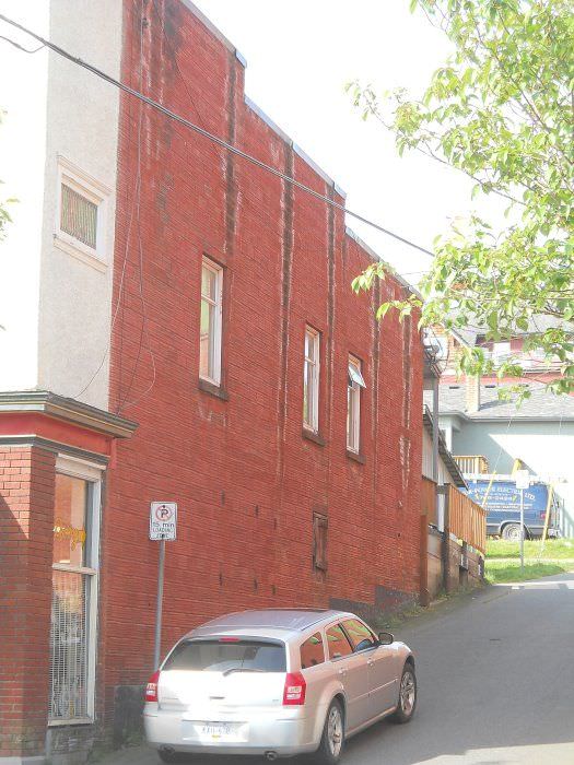

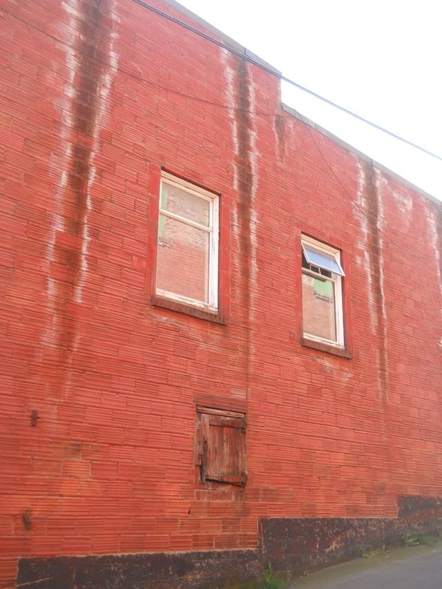

John Kogel Posted June 26, 2013 Report Share Posted June 26, 2013 This is a century old building in a town near here. If I was to inspect it, I would tell the owner to get the roof drainage issues repaired pronto. I have a question for Bill or other experts - Is or was it acceptable practice to lay these blocks on their sides as was done here? Click to Enlarge 86.98 KB Click to Enlarge 71.35 KB Click to Enlarge 101.33 KB Click to Enlarge 56.85 KB Quote Link to comment Share on other sites More sharing options...
Bill Kibbel Posted June 26, 2013 Report Share Posted June 26, 2013 yup. See the answer in the last post (#7) in this thread: https://www.inspectorsjournal.com/forum ... C_ID=14192 The blocks in your pictures are quite well-preserved, considering the manufacturer of those blocks intended them to be rendered (stuccoed) when exposed to the exterior. Click to Enlarge 32.05 KB Quote Link to comment Share on other sites More sharing options...
