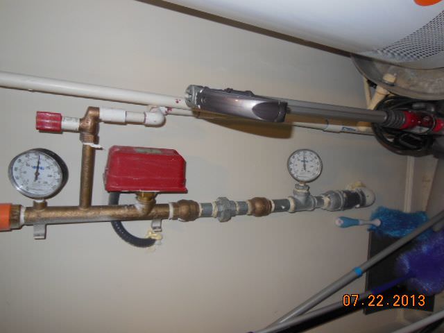

stanposs Posted July 21, 2013 Report Share Posted July 21, 2013 I inspected a condo in Atlanta today with a conventional Gas HVAC and hotwater system when I saw this setup. The plumbing is very heavy duty, the gauges read 150psi each, and it has a high pressure release? that drains into the common drain with the hotwater heater prv.. What normal home system could need a constant 150psi of water? Click to Enlarge 33.7 KB Quote Link to comment Share on other sites More sharing options...
John Kogel Posted July 21, 2013 Report Share Posted July 21, 2013 Condo building, strange plumbing, fire-red control box, multiple gauges and valves, sprinkler system. [] Quote Link to comment Share on other sites More sharing options...
Scottpat Posted July 21, 2013 Report Share Posted July 21, 2013 Yep, fire sprinkler system. The orange pipe on the left side and the red control box are dead give-a-ways..... Quote Link to comment Share on other sites More sharing options...
