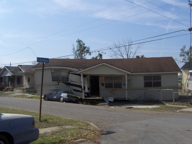

Bruce Thomas Posted December 11, 2005 Report Share Posted December 11, 2005 Daren, Here's my best one. Can any body tell me how this happened. Download Attachment: LAHouseOnCar.jpg 103.79 KB Bruce PS I'm Back from the south Link to comment Share on other sites More sharing options...
Michael Brown Posted December 11, 2005 Report Share Posted December 11, 2005 Sure, If it's from Katrina, I'd guess that it floated off it's foundation and the wind pushed it around. When the water receded it came down on top of whatever was underneath it. ONE TEAM - ONE FIGHT!!! Mike Link to comment Share on other sites More sharing options...
Bruce Thomas Posted December 11, 2005 Report Share Posted December 11, 2005 Mike, Right! I saw several of these. Both slab and piling homes that had moved just from the flood water. Bruce Link to comment Share on other sites More sharing options...

Chad Fabry Posted December 27, 2006 Report Share Posted December 27, 2006 Just a note: After having done the FEMA gig in N.O. and the surrounding areas post Katrina, I now believe there is no good way to tie a brick facade to a wood structure. Second only to roof damage was the masonry facades on lumber framed homes literally sucked (or blown) off of the house. Picture dozens of homes on a street where every one had the facde blown (sucked) off and currently residing horizontally in the front yard. Link to comment Share on other sites More sharing options...
