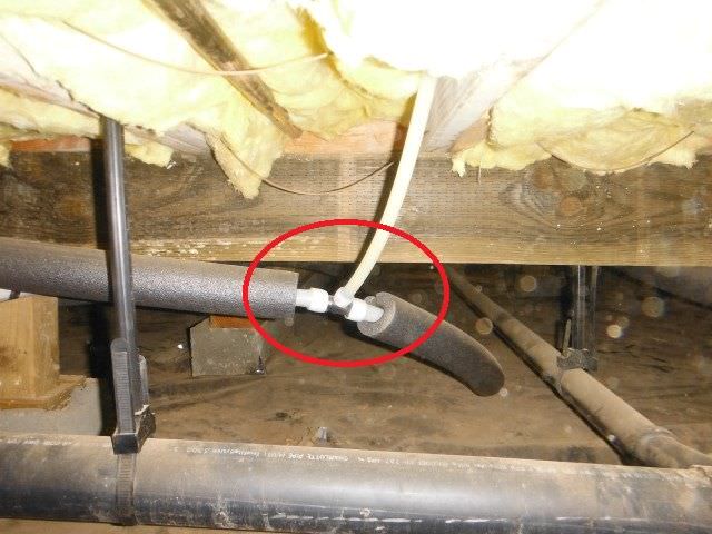

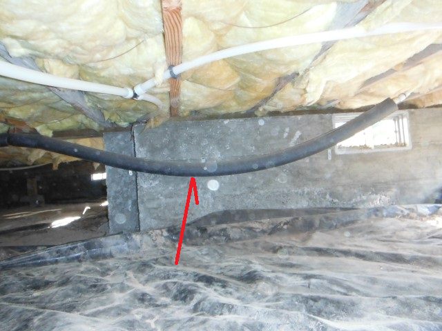

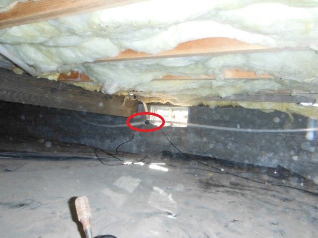

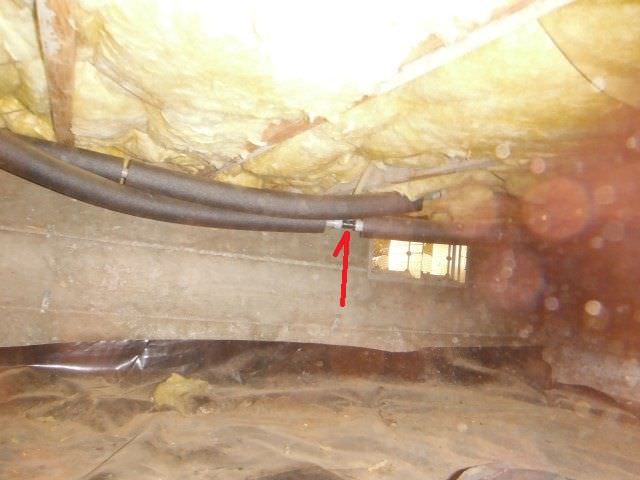

Denray Posted January 21, 2015 Report Share Posted January 21, 2015 I'm thinking that every one of these photos shows poor support for PEX. Am I correct? Click to Enlarge 60.89 KB Click to Enlarge 59.18 KB Click to Enlarge 48.81 KB Click to Enlarge 46.42 KB Click to Enlarge 46.63 KB Click to Enlarge 48.68 KB Download Attachment: 7.JPG 160.39 KB Quote Link to comment Share on other sites More sharing options...
Marc Posted January 21, 2015 Report Share Posted January 21, 2015 ZURN 'PEX Plumbing Design and Application Guide' says 32" apart max if not continuously supported and on each side of a bend. Seems like fittings should be supported also but this guide didn't say so. Marc Quote Link to comment Share on other sites More sharing options...
Denray Posted January 21, 2015 Author Report Share Posted January 21, 2015 That's what I was thinking Marc. 08 build and no leaks yet, but I should mention it. Thanks for the reply. I'll wait a few more hours before I send off the report for other comments. Quote Link to comment Share on other sites More sharing options...
Scottpat Posted January 22, 2015 Report Share Posted January 22, 2015 Need support at connectors in addition to the 32" requirement.. Quote Link to comment Share on other sites More sharing options...
