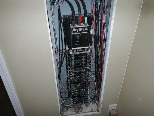

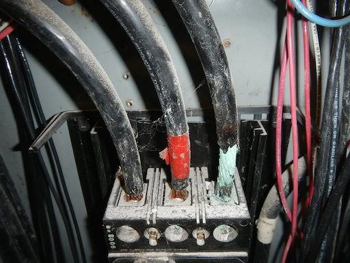

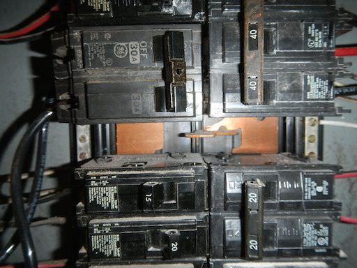

kurt Posted March 11, 2015 Report Share Posted March 11, 2015 Got a 3 phase panel (yes, with a burnt wire) that's only got a couple slots for 3 phase breakers. The rest of the breaker slots are only grab one or two bus. Pictures of the main, and a couple bus shots. What would this be called? Anything in particular? Overview Click to Enlarge 37.08 KB Close up disconnect Click to Enlarge 51.17 KB 110/240 slots Click to Enlarge 50.04 KB 3 phase slot; see the little tab sticking out from behind the barrier? Click to Enlarge 47.52 KB Quote Link to comment Share on other sites More sharing options...
Marc Posted March 11, 2015 Report Share Posted March 11, 2015 Assuming someone used red tape on the middle SE conductor because they were out of orange, I'd say it's a typical 120/240v, 3 phase, unbalanced neutral configuration. The unbalanced config gives you the 240v, 3 phase plus you can get 120 and 240 single phase via a center-tap on one of the legs. The center-tap is the neutral and since it isn't equidistant between all three legs (just between two of them), that makes the neutral unbalanced. The less common (in residential, apartments and condos) balanced config gives you 208v, 3 phase plus three legs of 120v. No 240v. If you drawn a triangle on paper and put a dot in the middle, that dot is the neutral. Each corner is a leg and they're all 120V from neutral. Between any two corners is 208v. Most resid 240 appliances also work on 208. They're labeled '240/208'. You'd have to check the voltage between any two SE conductors to be sure what you've got there. Looks like a 3 phase bus all the way from top to bottom. 3rd bus is mostly hidden behind plastic. Marc Quote Link to comment Share on other sites More sharing options...
Jim Katen Posted March 12, 2015 Report Share Posted March 12, 2015 I'd measure the voltages between the phases and between each phase and the neutral and then just describe it as a xxx amp, xxx/xxx volt three-phase load center. The schematic would tell the story of the bus configuration, but I suspect that Marc is right about the three phases alternating all the way down the bus. Quote Link to comment Share on other sites More sharing options...
kurt Posted March 12, 2015 Author Report Share Posted March 12, 2015 110 v between se and neutral, 220 between se's. 200 amp disconnect. No schematic. The guy wants to put a small cabinet shop into the place. No big shakes, a couple table saws, spray booth, the usual revolving stationary power tool setup. 3-4 guys working at a time. Seems like it would handle it ok. I've had shops that work fine with less. Thanx for the lesson. Quote Link to comment Share on other sites More sharing options...
kurt Posted March 12, 2015 Author Report Share Posted March 12, 2015 3rd bus is mostly hidden behind plastic. Marc Yeah, exactly. It only had a tab at a couple places. Quote Link to comment Share on other sites More sharing options...

Speedy Petey Posted March 15, 2015 Report Share Posted March 15, 2015 3rd bus is mostly hidden behind plastic. Marc Yeah, exactly. It only had a tab at a couple places. No, it had a "3rd buss" every third or second place. A 3-phase panel like that typically has the center buss running down the center mostly hidden by plastic. The outer two busses usually look like typical busses from a single-phase panel, only with different spacing. Also, do NOT use "220" as your voltage. It's either 120/240, or 120/208 volt. A 120/240V 3-phase panel will have a high leg of 208V, typically in the center. This panel has so many single-pole breakers in it that it has to be a 120/208V feed. In a 120/240V 3-phase panel with a lot of SP breakers you usually see a lot of empty spaces at every third position. Quote Link to comment Share on other sites More sharing options...
