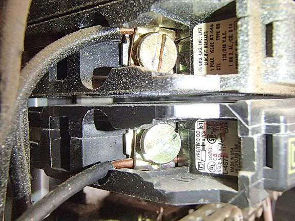

John Kogel Posted May 29, 2015 Report Share Posted May 29, 2015 A 1959 SquareD panel has two double taps. One is for the doorbell transformer installed and we assume approved by the authority in 1959. The other was added a decade or two later when the basement was dressed up. I don't believe the breaker is rated for double tapping due to its age. I believe the doorbell double tap is acceptable but not good practice. I called for the electrician to check the added circuit installation and repair it. When did SquareD start adding the two wire rating to their breakers? Click to Enlarge 32.68 KB Click to Enlarge 53.6 KB Click to Enlarge 68.9 KB Link to comment Share on other sites More sharing options...
Ken Meyer Posted May 29, 2015 Report Share Posted May 29, 2015 The type of Square D breakers that can accept two conductors have a plate with two raised areas. When the set screw is tightened, the plate exerts equal pressure on both conductors. Click to Enlarge 70.28 KB Link to comment Share on other sites More sharing options...
Jim Katen Posted May 30, 2015 Report Share Posted May 30, 2015 A 1959 SquareD panel has two double taps. One is for the doorbell transformer installed and we assume approved by the authority in 1959. The other was added a decade or two later when the basement was dressed up. I don't believe the breaker is rated for double tapping due to its age. I believe the doorbell double tap is acceptable but not good practice. I called for the electrician to check the added circuit installation and repair it. When did SquareD start adding the two wire rating to their breakers? I don't know when that happened. It might be interesting to find out, but from a need-to-know perspective, there'd be little point. As Ken pointed out, the ones that do accept two wires are readily identifiable in the field. I disagree about the doorbell transformer double tap being acceptable. It was wrong in '59 and it's wrong today. Link to comment Share on other sites More sharing options...
John Kogel Posted May 30, 2015 Author Report Share Posted May 30, 2015 A 1959 SquareD panel has two double taps. One is for the doorbell transformer installed and we assume approved by the authority in 1959. The other was added a decade or two later when the basement was dressed up. I don't believe the breaker is rated for double tapping due to its age. I believe the doorbell double tap is acceptable but not good practice. I called for the electrician to check the added circuit installation and repair it. When did SquareD start adding the two wire rating to their breakers? I don't know when that happened. It might be interesting to find out, but from a need-to-know perspective, there'd be little point. As Ken pointed out, the ones that do accept two wires are readily identifiable in the field. I disagree about the doorbell transformer double tap being acceptable. It was wrong in '59 and it's wrong today. The breakers I question are SquareD with two grooves in the bottom plate but a round washer for a top plate. I am calling those out for repair that is. Doorbell double tap - I do not disagree. The doorbell works fine though and has caused no obvious problem riding along on the breaker. Link to comment Share on other sites More sharing options...

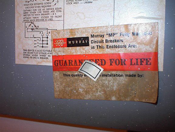

Jim Katen Posted May 30, 2015 Report Share Posted May 30, 2015 Good question. How old do breakers have to get before we don't trust them anymore? It probably varies between mfg's. Apparently we can trust Arrow Hart Murray MP breakers for as long as we live. Click to Enlarge 65.21 KB Link to comment Share on other sites More sharing options...
