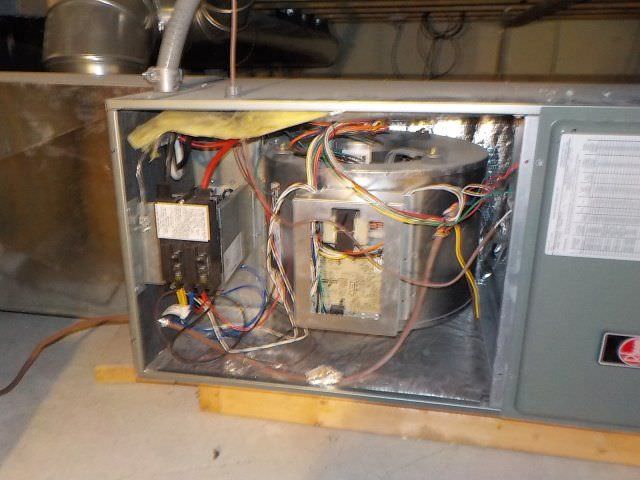

John Kogel Posted July 17, 2015 Report Share Posted July 17, 2015 This 5 year old Rheem electric furnace (giant toaster) had a normal thermostat that works. That is it works with a fresh pair of AA's from my tool bag, another goofy design. Besides the low voltage line entering the bottom of the cabinet from the thermostat I think, there is a second low voltage line into the top side that has been purposely disconnected. What would that be for? It terminates on a circuit board. Click to Enlarge 49.62 KB Click to Enlarge 55.4 KB Click to Enlarge 26.6 KB Click to Enlarge 37.87 KB Quote Link to comment Share on other sites More sharing options...
Marc Posted July 17, 2015 Report Share Posted July 17, 2015 Twin unit? Marc Quote Link to comment Share on other sites More sharing options...
inspector57 Posted July 17, 2015 Report Share Posted July 17, 2015 Provision for cooling unit or humidifier? Quote Link to comment Share on other sites More sharing options...
John Kogel Posted July 18, 2015 Author Report Share Posted July 18, 2015 Neither of those. Quote Link to comment Share on other sites More sharing options...
Jim Katen Posted July 18, 2015 Report Share Posted July 18, 2015 It would have been used to control a damper at the fresh air duct, which has since been removed or disconnected. Quote Link to comment Share on other sites More sharing options...
John Kogel Posted July 18, 2015 Author Report Share Posted July 18, 2015 Thanks, Jim. I will pass that along. Quote Link to comment Share on other sites More sharing options...
