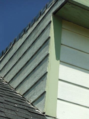

Denray Posted August 28, 2015 Report Share Posted August 28, 2015 First time I've seen this. Click to Enlarge 77.78 KB Quote Link to comment Share on other sites More sharing options...
kurt Posted August 28, 2015 Report Share Posted August 28, 2015 Step rake. Only seen in ancient civilizations. Usually indicates visitation by extraterrestrials. Quote Link to comment Share on other sites More sharing options...
Marc Posted August 28, 2015 Report Share Posted August 28, 2015 If I'm seeing this right, the photo shows two rakes, one steep, one shallow that is set back from the steep one. Let me guess...there's no cornice on the upper rake? Which means there's no overhang on it. Marc Quote Link to comment Share on other sites More sharing options...
Denray Posted August 28, 2015 Author Report Share Posted August 28, 2015 Click to Enlarge 34.3 KB Click to Enlarge 58.63 KB Quote Link to comment Share on other sites More sharing options...

Steven Hockstein Posted August 28, 2015 Report Share Posted August 28, 2015 The salesman at The "Big Box" Store told the roof installer that you need to use flashings when you install a roof. I can only imagine the installer bought 4" x 8" flashing pieces and used them. Never mind that you are supposed to use the right materials and install them in the correct locations. I also just noticed that there are no vents in the soffits. Quote Link to comment Share on other sites More sharing options...
Denray Posted August 28, 2015 Author Report Share Posted August 28, 2015 No vents in the roof either. She's sealed up gootentite. Click to Enlarge 25.87 KB Click to Enlarge 48.78 KB Quote Link to comment Share on other sites More sharing options...

kurt Posted August 28, 2015 Report Share Posted August 28, 2015 Looks like a Chicago Bungalow "Rehab". Takes about 2-3 years for the roof peak to rot out. In your climate, maybe it'll take 5-7. Quote Link to comment Share on other sites More sharing options...
