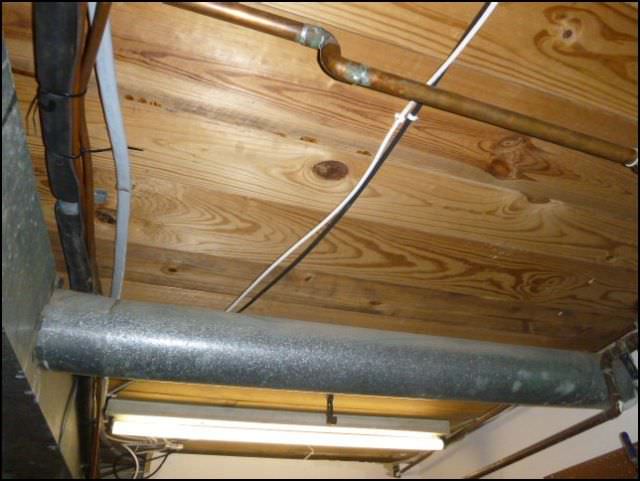

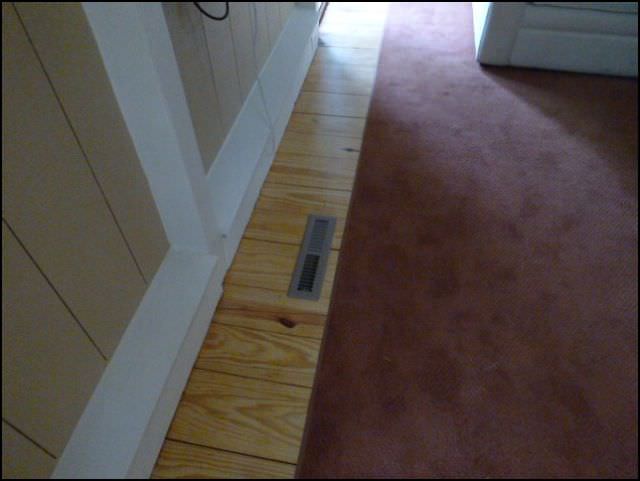

John Dirks Jr Posted June 12, 2016 Report Share Posted June 12, 2016 I saw something for the first time today. Laminated tounge in groove pine planks that spanned between beams without joists of any kind. The laminated planks were three pieces of pine plank that totaled about 2 or more inches thick. There were three structural beams between the foundation walls instead of the usual one in the middle. That divided the distance from wall to wall into 4 spans. The floors were very solid. Anyone have information on this construction type? Click to Enlarge 35.73 KB Click to Enlarge 54.84 KB Quote Link to comment Share on other sites More sharing options...

Jim Katen Posted June 12, 2016 Report Share Posted June 12, 2016 Looks like it. What makes you think that the 2x6s are laminated? Traditional construction around here is girders every 3 or 4 feet with 2x6 tongue & groove "car decking" between them. No joists. That usually forms the subfloor though. Very few people use it as a finished floor - although it's like that in my house. Quote Link to comment Share on other sites More sharing options...
John Dirks Jr Posted June 12, 2016 Author Report Share Posted June 12, 2016 Looks like it. What makes you think that the 2x6s are laminated? Traditional construction around here is girders every 3 or 4 feet with 2x6 tongue & groove "car decking" between them. No joists. That usually forms the subfloor though. Very few people use it as a finished floor - although it's like that in my house. When I pulled a register damper from the main floor I could see a cross section of the laminated planks. I should have took a picture because it was clearly three pieces of 1x6 pine laminated together with tounge in groove cut in to lock it all together. Quote Link to comment Share on other sites More sharing options...
ghentjr Posted June 12, 2016 Report Share Posted June 12, 2016 Looks like it. What makes you think that the 2x6s are laminated? Traditional construction around here is girders every 3 or 4 feet with 2x6 tongue & groove "car decking" between them. No joists. That usually forms the subfloor though. Very few people use it as a finished floor - although it's like that in my house. When I pulled a register damper from the main floor I could see a cross section of the laminated planks. I should have took a picture because it was clearly three pieces of 1x6 pine laminated together with tounge in groove cut in to lock it all together. Google " Deck House ". That is what their flooring systems look like. Quote Link to comment Share on other sites More sharing options...

gtblum Posted June 12, 2016 Report Share Posted June 12, 2016 Probably the light or something, but from here it almost looks like the top is oak or ash. The bottom is definitely pine. Am I seeing it right? Quote Link to comment Share on other sites More sharing options...
John Dirks Jr Posted June 12, 2016 Author Report Share Posted June 12, 2016 Probably the light or something, but from here it almost looks like the top is oak or ash. The bottom is definitely pine. Am I seeing it right? It may be a combination of species. I'll check that out further if I go back. If the top is hardwood and the bottom is pine, I'm sure I'll be able to probe and tell the difference in hardness. Quote Link to comment Share on other sites More sharing options...
