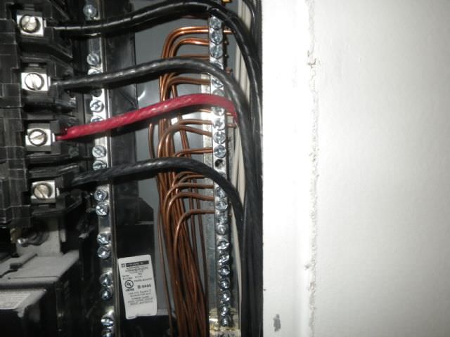

palmettoinspect Posted June 29, 2016 Report Share Posted June 29, 2016 I need some reassurance on an issue. I did a reinspect on a new construction home with the main disconnect located at the meter. The main distribution panel wired as a sub panel with a 4 wire feeder and ground and neutral separated. The bonding screw was removed from the neutral bar, but missing at the ground bar. The electrician is stating if he bonds the ground bar to the panel that the AFCI breakers will trip and he can't do that?!? Am I missing something here? Thanks, Kiel Click to Enlarge 44.93 KB Quote Link to comment Share on other sites More sharing options...
Marc Posted June 29, 2016 Report Share Posted June 29, 2016 Baloney! Is this a multi-family dwelling or detached single family? Marc Quote Link to comment Share on other sites More sharing options...
palmettoinspect Posted June 29, 2016 Author Report Share Posted June 29, 2016 Single family detached. Quote Link to comment Share on other sites More sharing options...
Marc Posted June 29, 2016 Report Share Posted June 29, 2016 The sparky is wrong. Check the AFCI wiring: Branch circuit neutral and hot both run directly to the AFCI device. White pigtail on AFCI runs to neutral bar. It may be that this sparky did a job where he had problems with a newly installed AFCI tripping and thought he had wired it wrong but the issue was a fixture or appliance that was sparking. I had one of those myself and it can be a PITA to figure out where the sparking is taking place. These AFCIs work very well. Marc Quote Link to comment Share on other sites More sharing options...

Chad Fabry Posted June 29, 2016 Report Share Posted June 29, 2016 Ask the electrician how he managed to avoid incidental contact between the panel and the bare grounds. Then tell him it's required to bond the equipment to ground. Quote Link to comment Share on other sites More sharing options...
