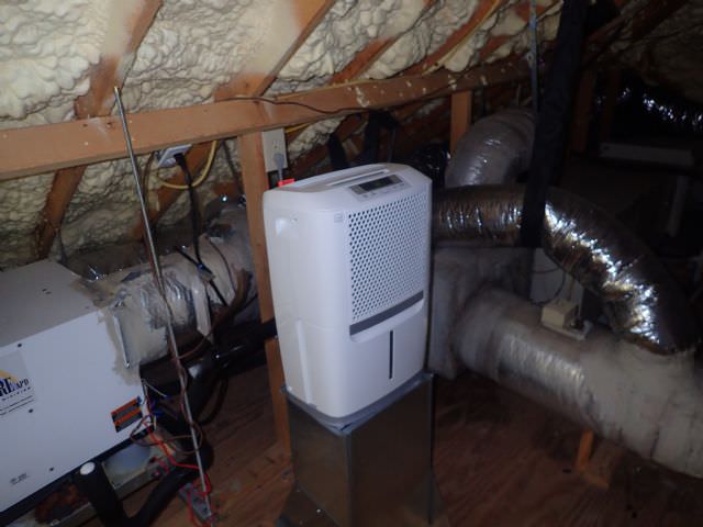

palmettoinspect Posted March 1, 2017 Report Share Posted March 1, 2017 Typically it's open cell that's used around here. You do see closed cell used in attics from time to time and it's being used more often, but mostly open cell. I think it's mainly cost. Closed cell works the best to encapsulate and stop air travel though. Many who are using spray foam in the attics are using it to encapsulate the attics more to reduce excessive humidity rather than the insulation value. The spray foam is used along with dehumidifiers to block the ventilation and reduce humidity. If you have a beach or water front home here it's a must do thing. Click to Enlarge 43.85 KB Link to comment Share on other sites More sharing options...

palmettoinspect Posted March 2, 2017 Report Share Posted March 2, 2017 Great reads! In my experience sealing that attic with spray foam alone doesn't help much and doesn't create a conditioned attic space. You must mechanically condition the attic. Whether it's with the heating and air ducts or dehumidifiers. I've seen attics that used both the heating and air and dehumidifiers and one or the other. The problem with using the heating and air equipment and ducts is, you must install both a supply and returns. Supplies only dumping into the attic only make things worse. There must be a return to extract the moisture. The problem with many of the beach homes that truly need a condition attic is they're second homes and when vacant and not in regular use the AC isn't on and there's no dehumidification happening. In my experience conditioned attics that are sealed and use dehumidifiers, whether it's spray foam or some other type of material used to block the attic ventilation works the best. The dehumidifier being key. The dehumidifier also needs to be sized properly for the space and in some cases of chopped up attics need multiple units or ducts for the dehumidifiers are needed. I'm not a huge fan of spray foam, but will agree it's the best way to get a pretty air tight space. Conditioned attic spaces can be archived without using spray foam by just blocking the ventilation and using a dehumidifier. Link to comment Share on other sites More sharing options...
