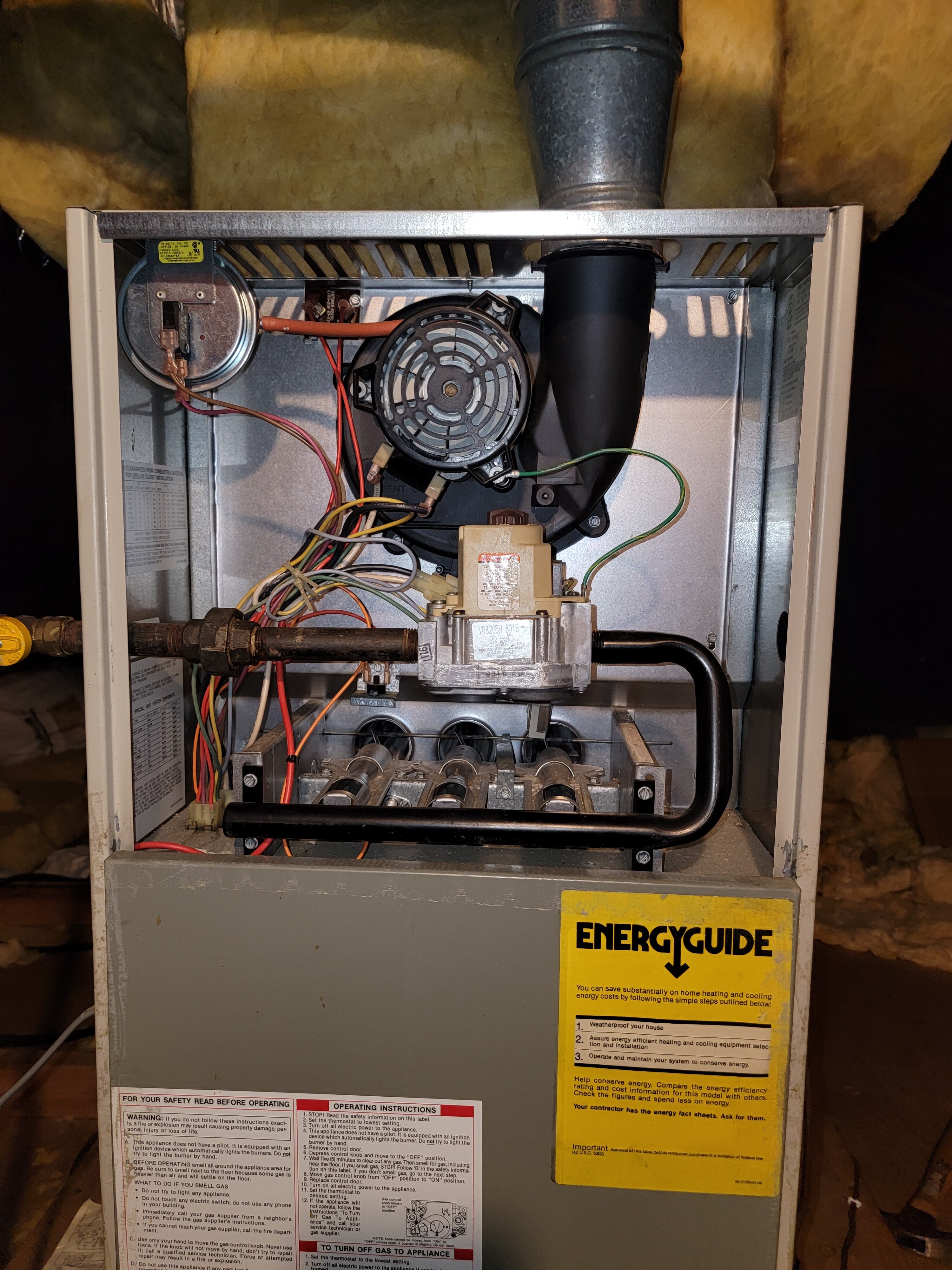

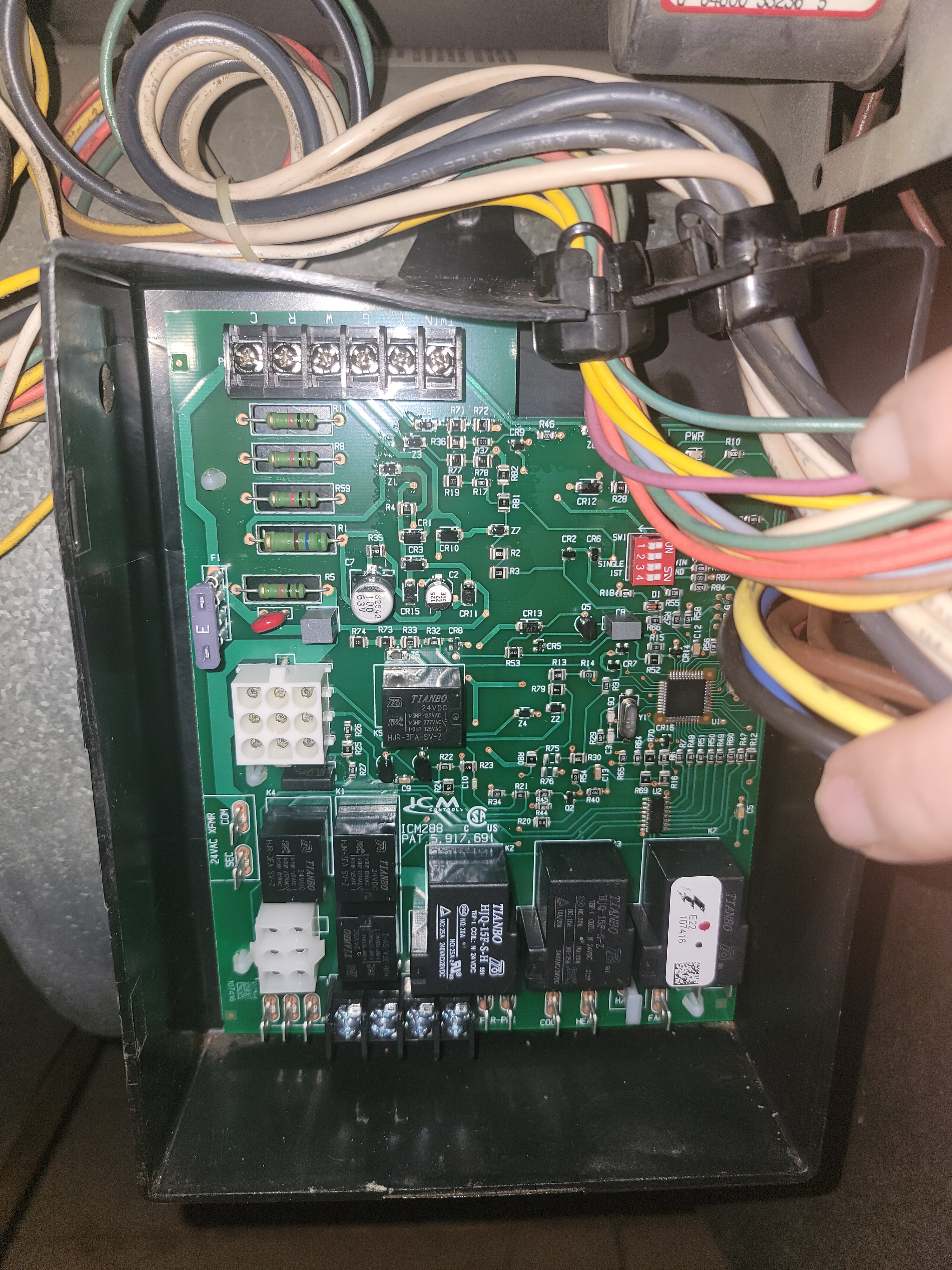

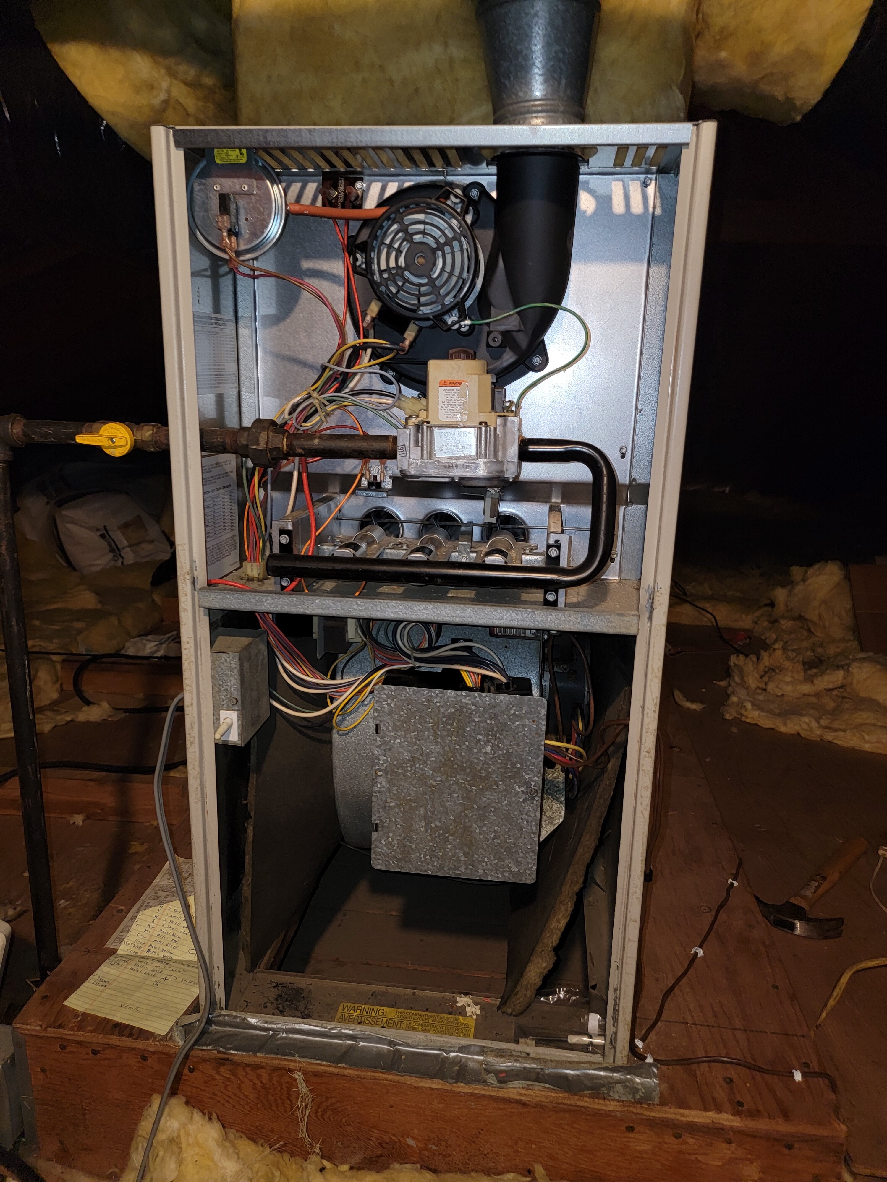

Troyster510 Posted November 29, 2022 Report Share Posted November 29, 2022 I completely installed the new board. It mostly works. The igniter starts the burners (which is something the old board wasn't doing anymore), but as soon as the igniter shuts off, the burners shut off too. I've tried cleaning the flame sensor, but that had no positive effect. The flame sensor looked fairly clean anyway. At this point I'll need to hook the flame sensor up to a meter to see if it's generating current. I've already checked the continuity of the flame sensor wire. I have the wire connected to M1 on the board. Quote Link to comment Share on other sites More sharing options...

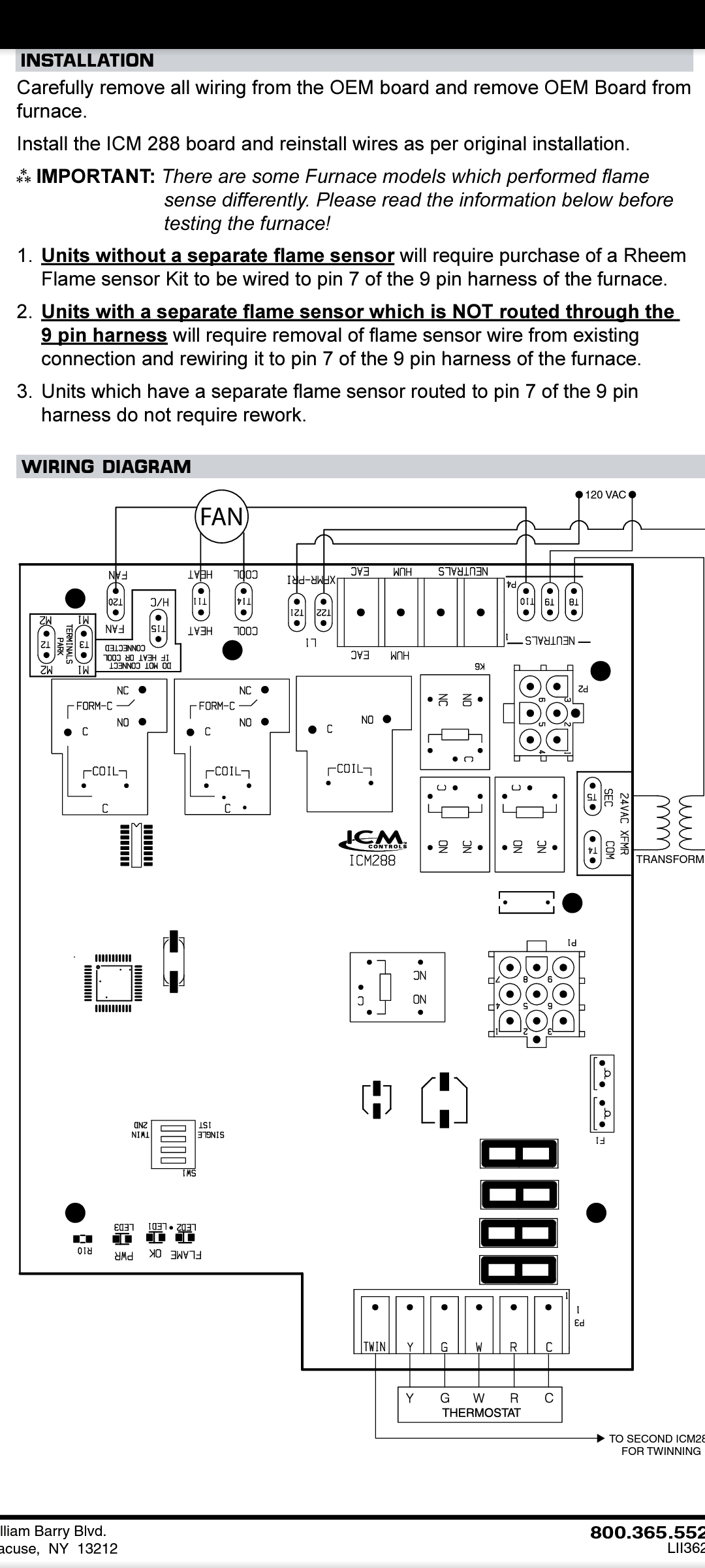

Troyster510 Posted November 29, 2022 Report Share Posted November 29, 2022 Looks like there's a modification required. According to this diagram the flame sensor wire needs to be moved from its previously designated spot over to pin 7. Quote Link to comment Share on other sites More sharing options...

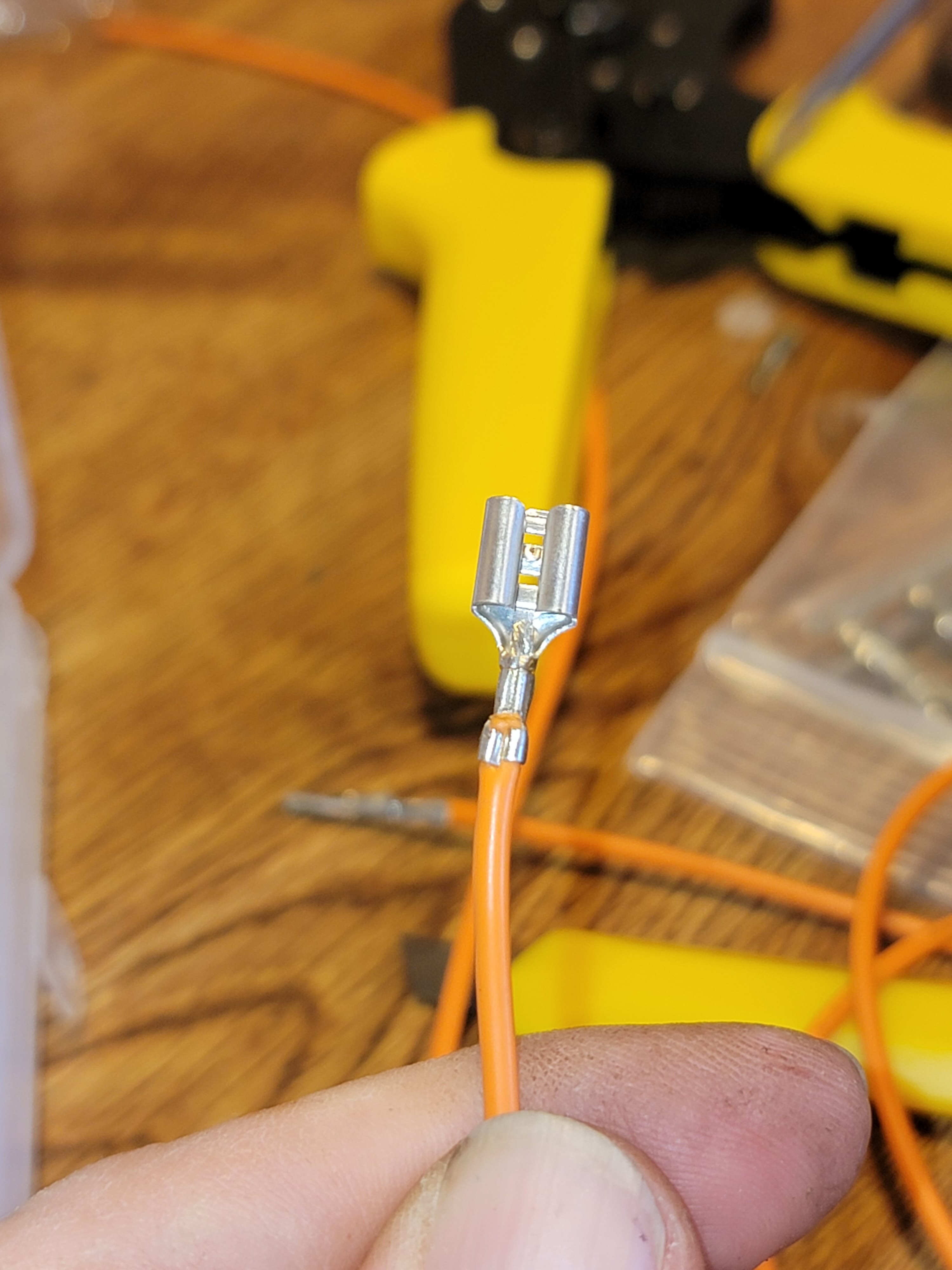

Troyster510 Posted December 1, 2022 Report Share Posted December 1, 2022 I take that back. After looking over everything more carefully it looks like I need to move pin 3 wire in p2 (6 pin harness) and move it to pin 7 hole in p1 (9 pin harness). I may need a Molex extraction tool. I've tried using tiny wires with no success. Quote Link to comment Share on other sites More sharing options...

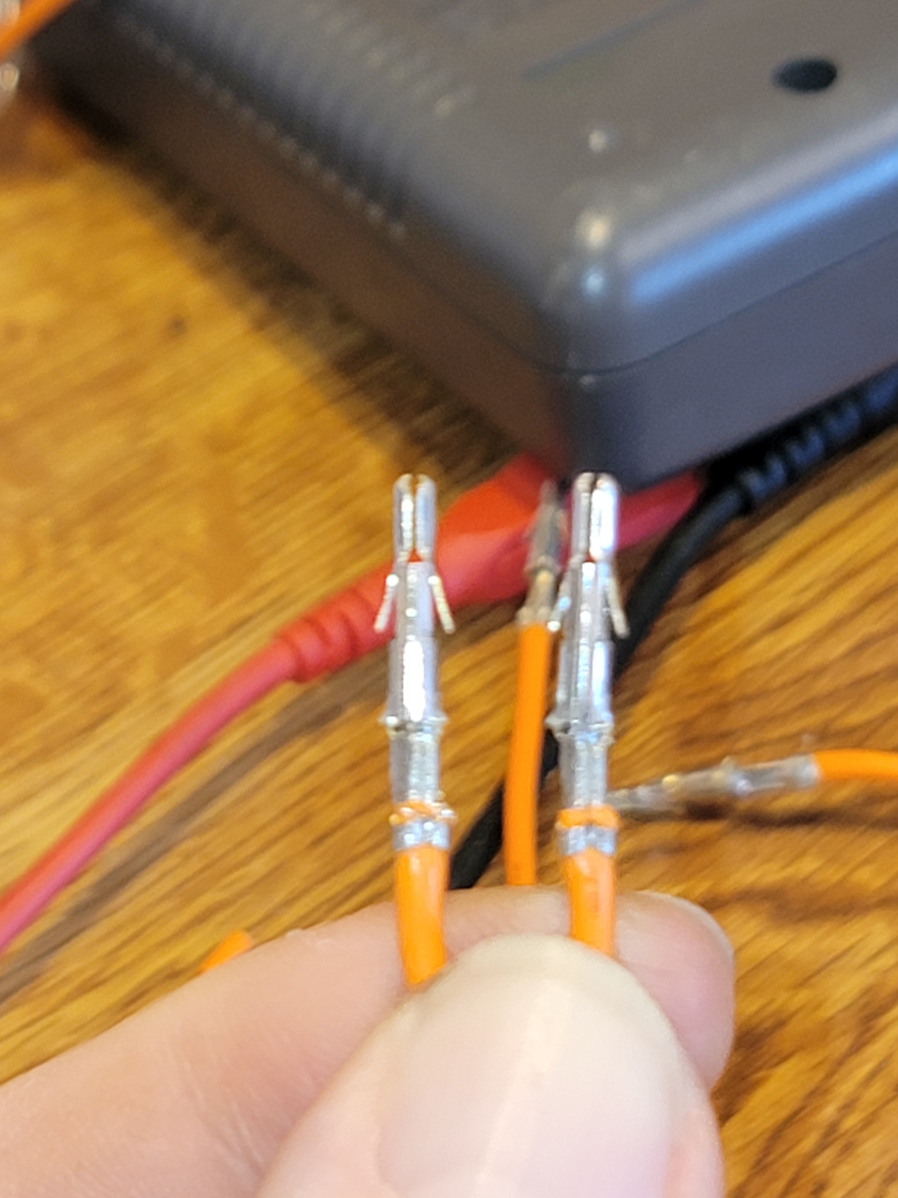

Troyster510 Posted December 2, 2022 Report Share Posted December 2, 2022 I have the heater running in a temporary way at the moment. One thing that threw me off was that the igniter and flame sensor both share the same neutral wire. When I was trying to get a micro amps reading I had no idea that all the amps were basically being grounded out by the neutral wire. As a temporary test only fix, I ran a wire from the flame sensor directly to pin 7 in the 9 pin harness. I saw the orange light light up to let me know the board detected a flame and the burners remained on. I was pretty relieved. I'll send an update with photos once I have the fix permanent. Quote Link to comment Share on other sites More sharing options...

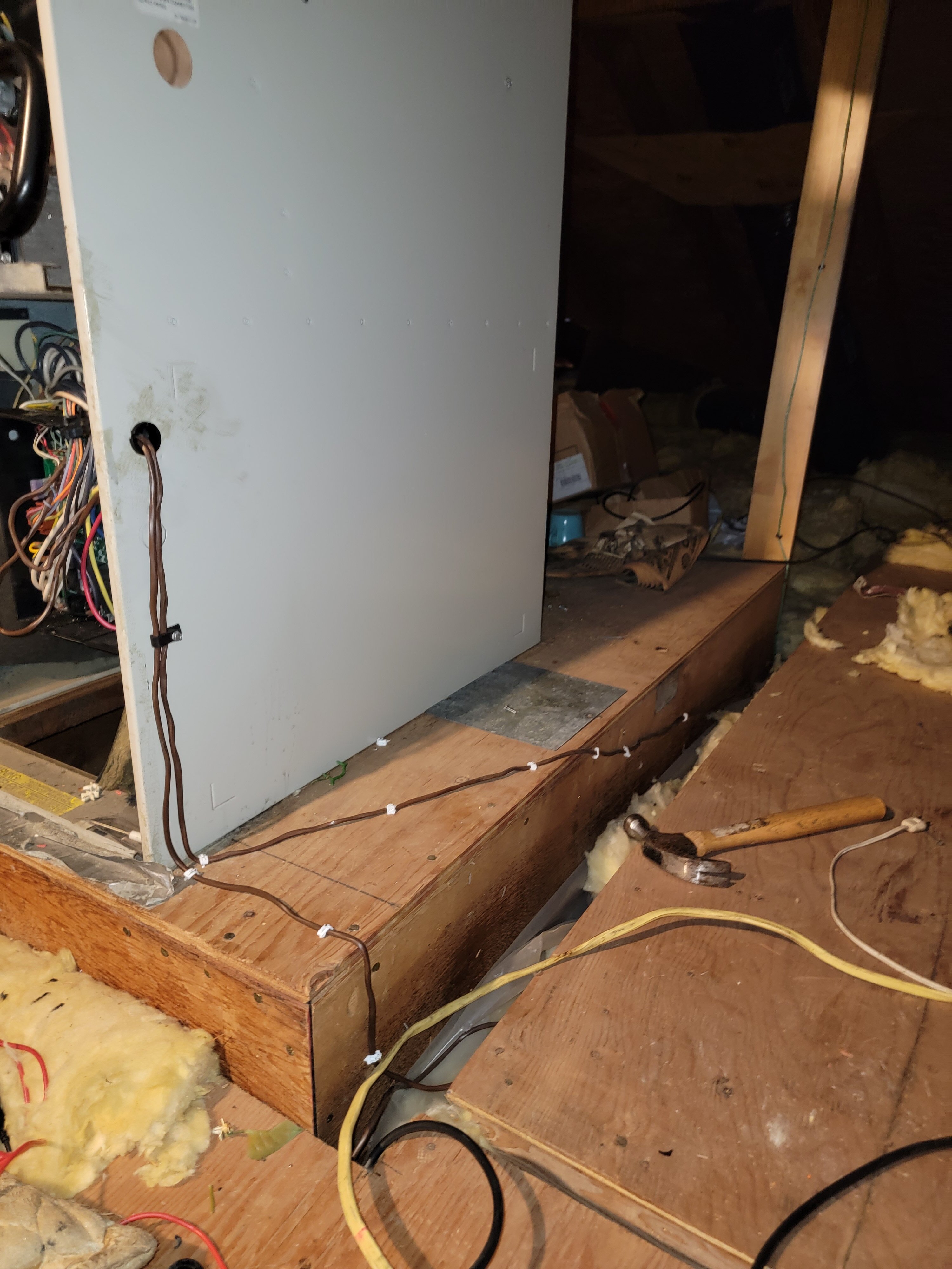

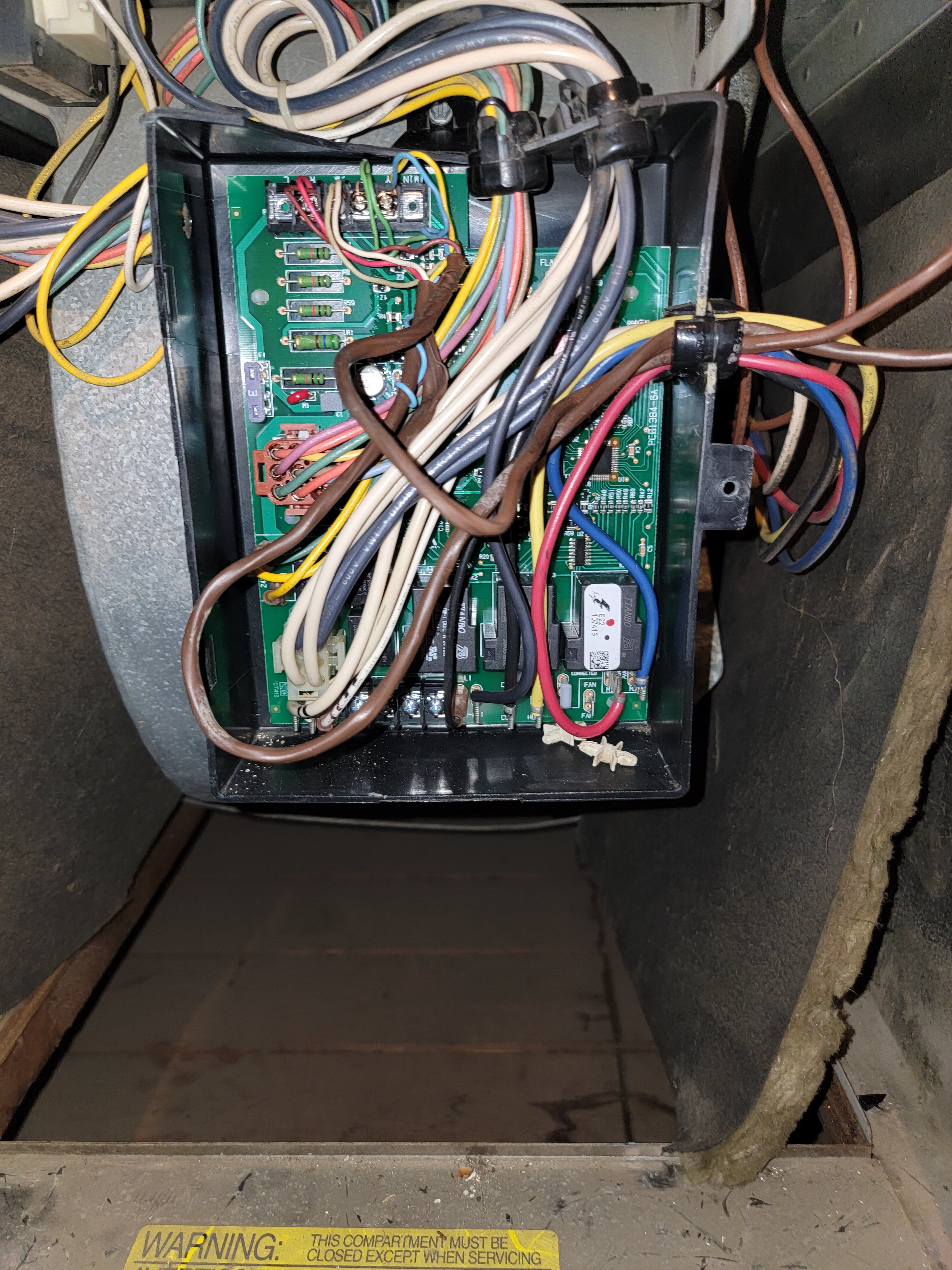

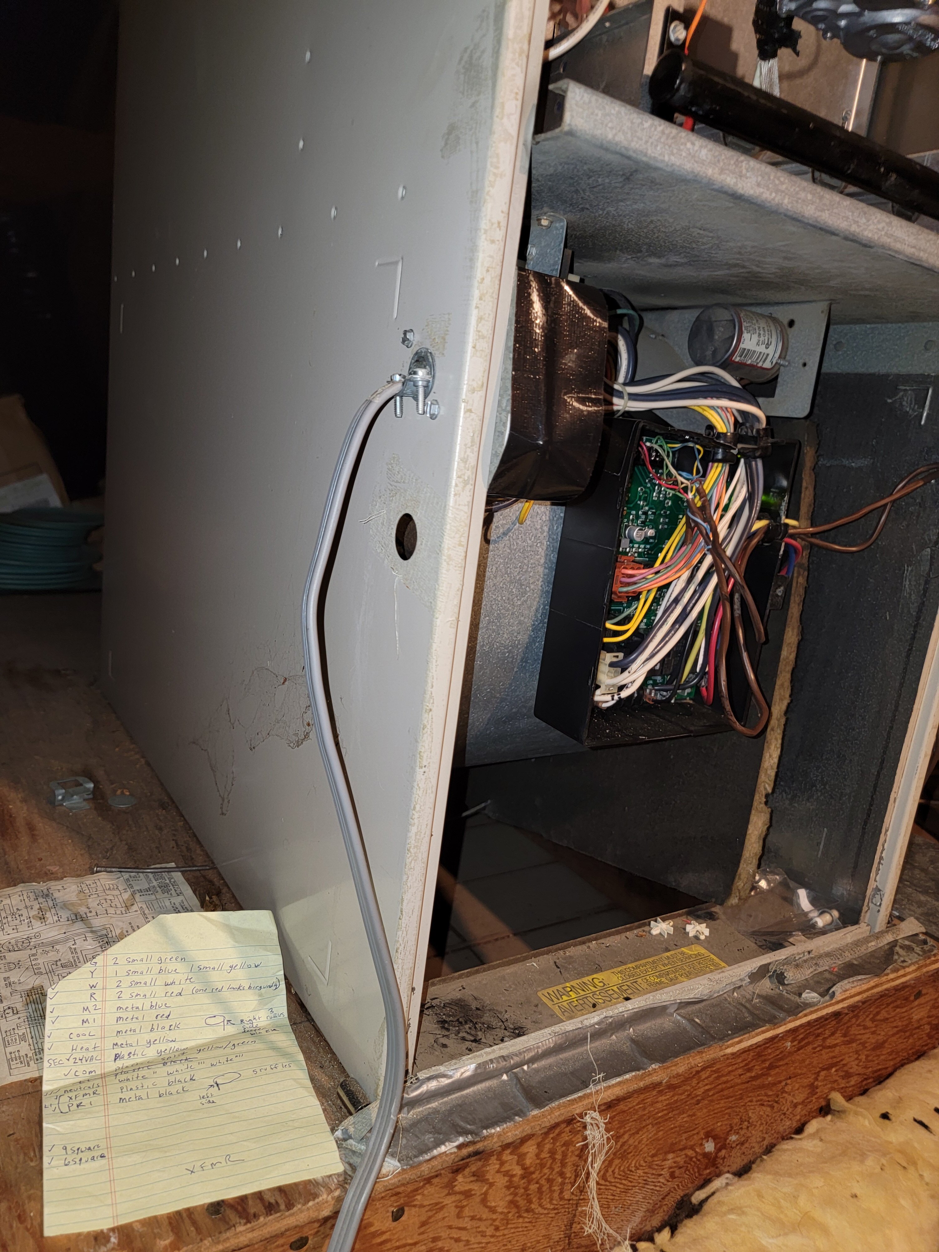

Troyster510 Posted December 14, 2022 Report Share Posted December 14, 2022 Quote Link to comment Share on other sites More sharing options...
Troyster510 Posted December 14, 2022 Report Share Posted December 14, 2022 High temp orange stranded wire. Quote Link to comment Share on other sites More sharing options...
