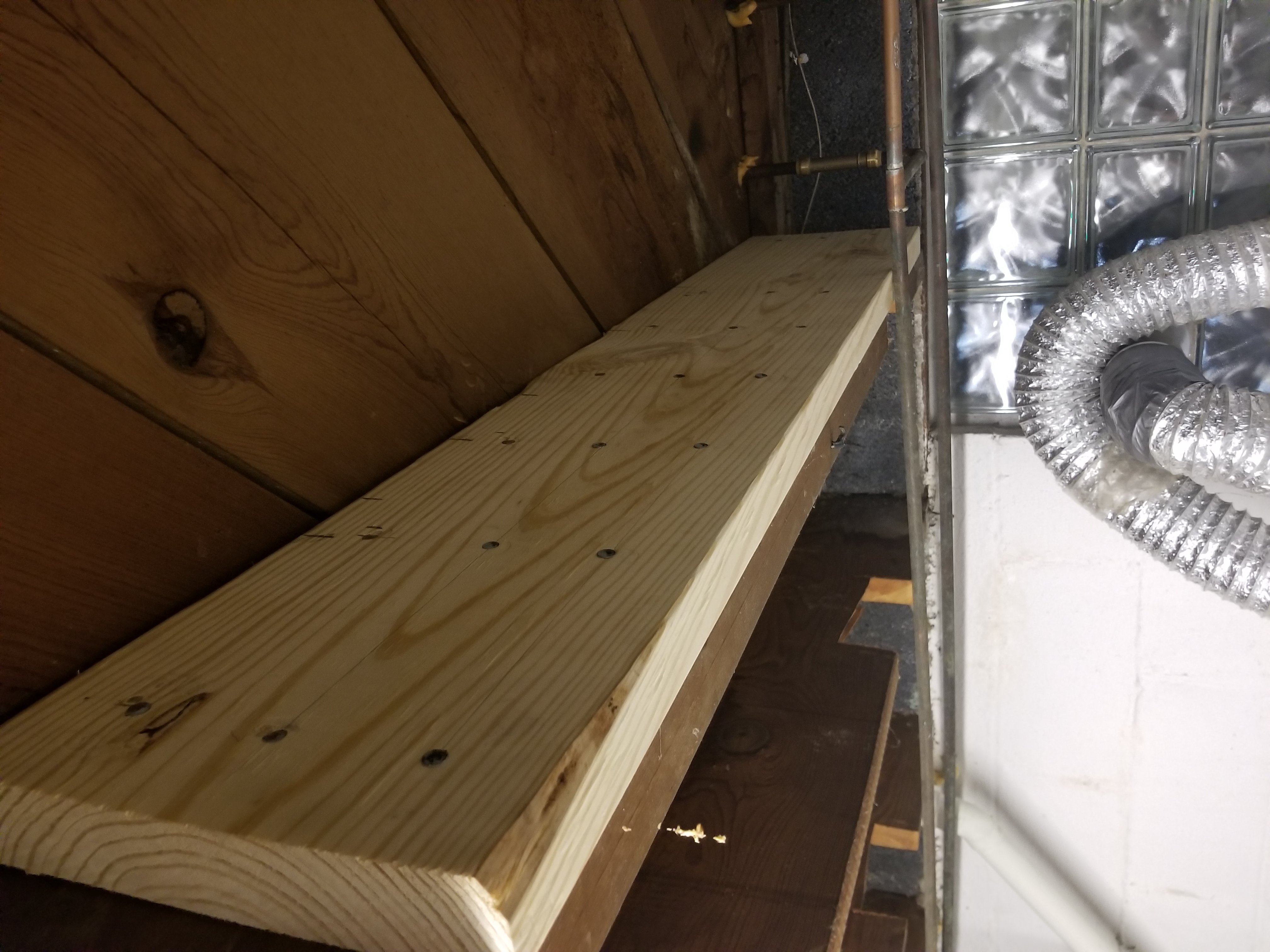

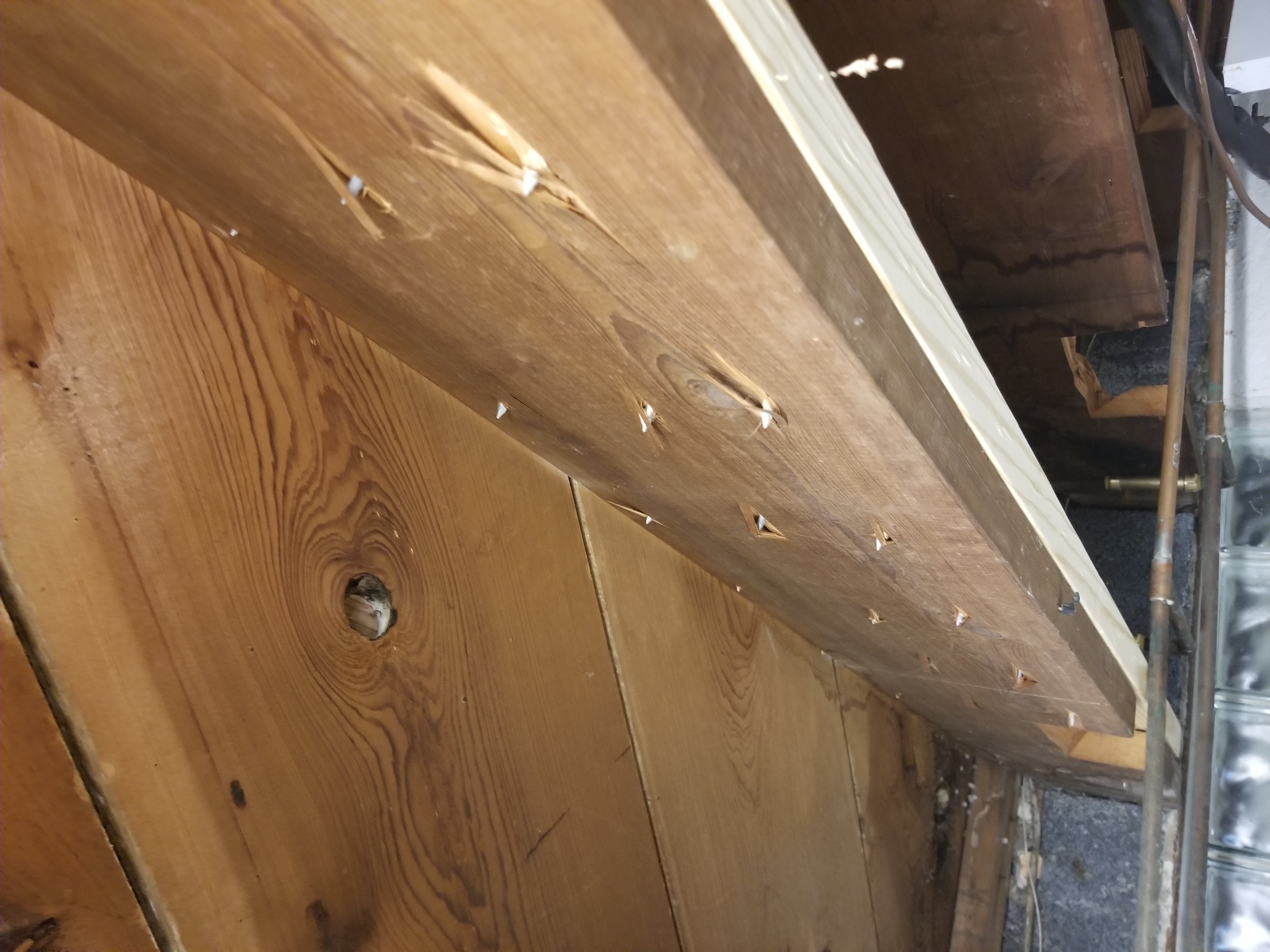

Alex5 Posted January 11, 2019 Report Share Posted January 11, 2019 I'm sistering some knotched floor joists in my house. I'm using 3 1/2in 16D nails spacing them 6-8in apart on the board with 3 nails in each column so approximately 21 nails per 4ft board. The nails do stick out the other side of the floor joist and I read elsewhere that this is fine. So for those that have done this kind of work before do these pictures look like everything is good? Does it not matter that the original floor joist kinda loses a bit of wood as the nail punches through the other side? Quote Link to comment Share on other sites More sharing options...
Bill Kibbel Posted January 11, 2019 Report Share Posted January 11, 2019 I would prefer glue and screw. Some engineers here insist on bolts. Quote Link to comment Share on other sites More sharing options...
Jim Katen Posted January 11, 2019 Report Share Posted January 11, 2019 It ain't goin' nowhere. Quote Link to comment Share on other sites More sharing options...
Jim Baird Posted January 15, 2019 Report Share Posted January 15, 2019 ...if all you are doing is making up for that notch you are doing fine. That kind of scabbing can also be done with plywood and screws. Looks like you had plenty of room to swing a hammer down there. I have seen lots of floor joists way overnotched at their very ends that have lasted fifty years without failing. Quote Link to comment Share on other sites More sharing options...
ejager Posted January 19, 2019 Report Share Posted January 19, 2019 That sistering work looks good. As Bill alread suggested, glued is my preference. On 1/15/2019 at 6:58 AM, Jim Baird said: ... I have seen lots of floor joists way overnotched at their very ends that have lasted fifty years without failing. Some of the wood we used 50 yrs ago up here would have been able to withstand that. The stuff that couldn't has of course been replaced; is that maybe why we don't see it, and why there are codes against it? Quote Link to comment Share on other sites More sharing options...
