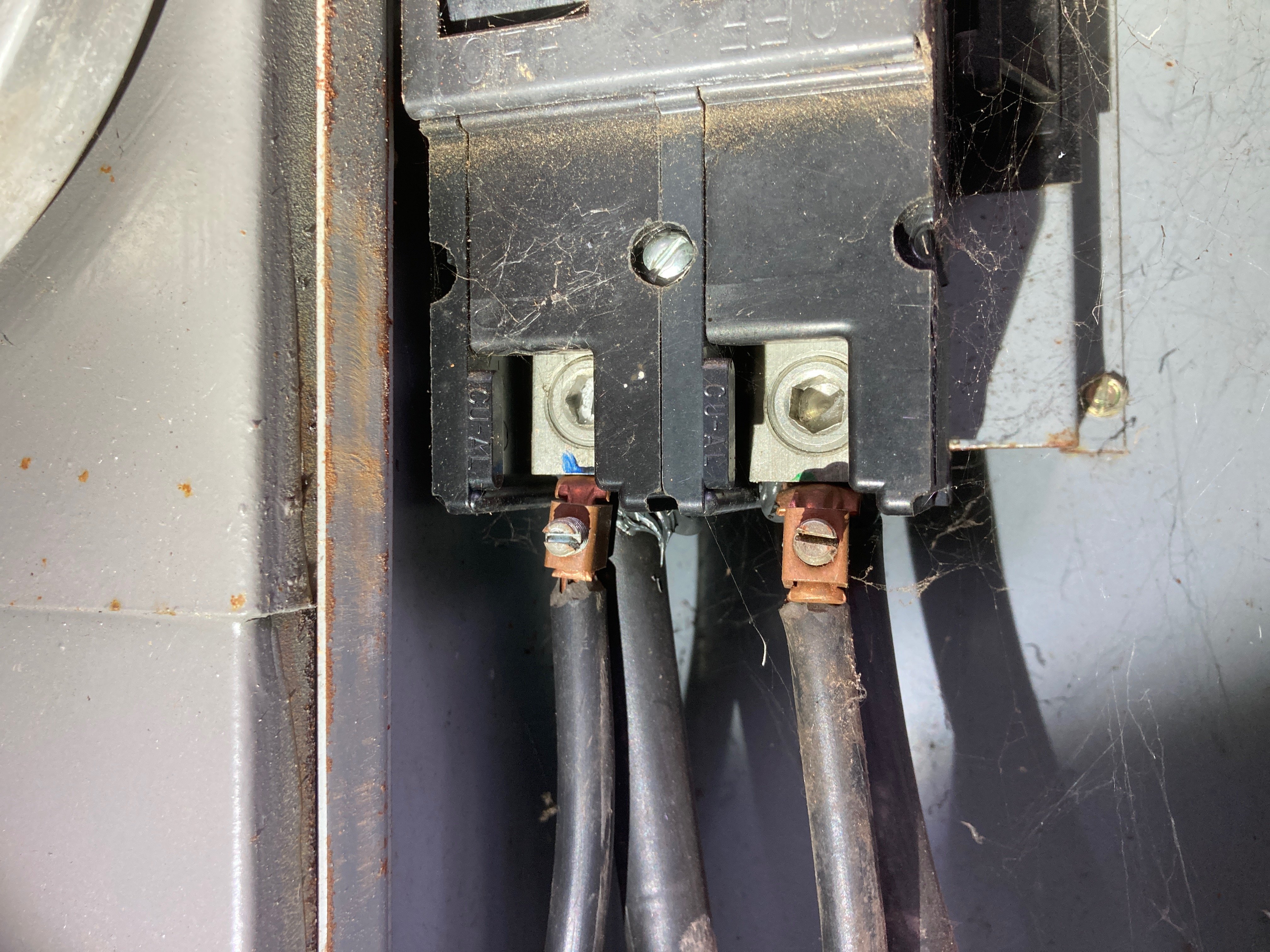

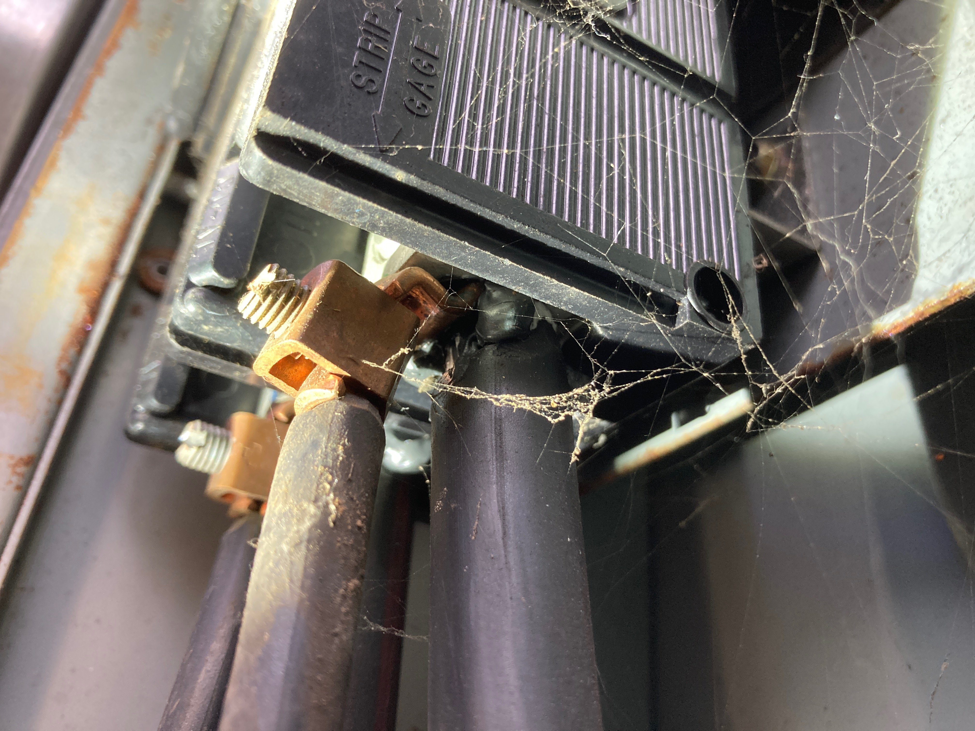

CNewhouse Posted January 22, 2022 Report Share Posted January 22, 2022 Would this be considered a double tap? I don't think I've ever seen this done. Link to comment Share on other sites More sharing options...
CNewhouse Posted January 22, 2022 Author Report Share Posted January 22, 2022 (edited) Wondering if the connector would prevent the lug from securing the 4/0 aluminum conductors properly. Edited January 22, 2022 by CNewhouse Changed mind Link to comment Share on other sites More sharing options...
Marc Posted January 22, 2022 Report Share Posted January 22, 2022 I doubt the breaker's connector was engineered for that. Also, paralleled conductors need to be same material, size and length, so that the current divides evenly between them. Write that baby up. Link to comment Share on other sites More sharing options...
Bill Kibbel Posted January 22, 2022 Report Share Posted January 22, 2022 Then there's that copper on aluminium thing. Link to comment Share on other sites More sharing options...
CNewhouse Posted January 22, 2022 Author Report Share Posted January 22, 2022 I was wondering about the copper and aluminum. Thanks fellas. Link to comment Share on other sites More sharing options...
Jim Katen Posted January 23, 2022 Report Share Posted January 23, 2022 All the connections in that meter main are incorrectly made. I doubt it was done by an electrician. Link to comment Share on other sites More sharing options...
