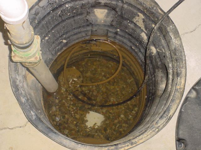

a46geo Posted January 31, 2004 Report Share Posted January 31, 2004 What is happening here? I did an inspection of a condo today. It was the end unit of a 4 unit building. No seller present. The disclosure statement says a french drain had been installed two years ago. The sump is filled with gravel and the pump motor is buried in the gravel and still plugged into a live outlet. The float is also buried in the gravel. There is about 4 inches of water in the sump but there is no sign of this thing ever overflowing. Download Attachment: DSC00102.JPG 152.39 KB Link to comment Share on other sites More sharing options...
hausdok Posted January 31, 2004 Report Share Posted January 31, 2004 A guess, They installed a french drain, used pea gravel small enough to fall into the perf pipe instead of quarterstone and never sleeved the pipe. The gravel has been falling into the pipe and is being washed to the sump well where it buried the pump and float. Since it hasn't overflowed, the ground probably perks well and the pump was probably not necessary. My guess, can't theorize much else without seeing/knowing more. [:-blindfold] ONE TEAM - ONE FIGHT!!! Mike Link to comment Share on other sites More sharing options...
a46geo Posted January 31, 2004 Author Report Share Posted January 31, 2004 Thanks Mike, That is as good of a guess as any. I have never seen anything like this. I just wrote it up an "beats me" (not like that of course) and called for a look see by the aassociations plumber to investigate. George Link to comment Share on other sites More sharing options...
