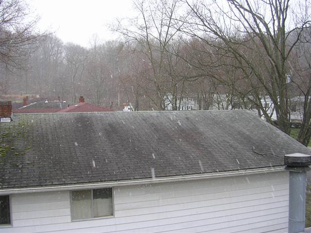

Terence McCann Posted March 14, 2006 Report Share Posted March 14, 2006 What might be the possible causes for the black/grey streaking found on these roofs? Not only did the home I was inspecting have it but nearly every neighbors home had it as well. To the best of my knowledge there are no factories in close proximity. Download Attachment: 1.jpg 70.79 KB Download Attachment: 2.jpg 65.66 KB Link to comment Share on other sites More sharing options...
Bain Posted March 14, 2006 Report Share Posted March 14, 2006 The black streaks are most likely a fungal growth, much like the algae and/or lichens on the left side of the roof in the photo. At various seminars, the experts--alleged, anyway--claim that the growth is caused by vegetation blocking the sun and/or the house's position vis a vis the sun. Link to comment Share on other sites More sharing options...
hausdok Posted March 14, 2006 Report Share Posted March 14, 2006 Hi, Yeah, it's algae. Folks often mistake it for dirt, weathering or smoke. There's no alleging to it. It's a fact. It eventually develops on the north and east sides of every roof here, unless special shingles that have copper included in the granular coating are used. It also develops on the sunny south and west sides in any areas shaded by trees or chimneys or adjacent roof planes or houses. Algae secretes oxalic acid. Leave it there long enough and it can actually harm an asphalt roof. I've had roofs where the south slope, where the sun hits it, is clean, algae free and nice and supple and the north slope, where the algae stains are, will show more wear and be brittle and nearly crystalized. Same product, installed at the same time on the same house, but with very different conditions of serviceability. I always get a chuckle out of all of the home inspection texts that show the south slope of roofs being the one that will wear out first due to sunlight exposure. That might be true in other parts of the country but not here. Here it's almost always the north or east side or areas in the shade and the sunny sides, where the sunlight kills the algae, can look great at 20 years while the north sides look like they've been on 30. It's easily removed with a mixture of gallon of liquid sodium hypochlorite (swimming pool chlorine) 3-1/2 gallons of water and a pint of non-ammoniated liquid dishwashing detergent. Wet down and cover plants and grass beneath the eaves to protect them from the overspray, mist the roof with a garden hose, apply the solution working from the eaves to the ridge, allow it to work and then rinse it off with low pressure water. ONE TEAM - ONE FIGHT!!! Mike Link to comment Share on other sites More sharing options...
Terence McCann Posted March 14, 2006 Author Report Share Posted March 14, 2006 Would Zinc or Copper strips nailed at the ridge stop this stuff? Link to comment Share on other sites More sharing options...
hausdok Posted March 14, 2006 Report Share Posted March 14, 2006 Hi, Sure, if you want to install them every 3ft. or so about every 10 or courses. After about 3ft. they aren't very effective. The homeowners put them on themselves around here. They invariably leak around the nails used to secure them to the roof because they don't bother to seal them or place them under an overlapping shingle and the danged things get hooked by the wind, break off and then look like hell. OT - OF!!! M. Link to comment Share on other sites More sharing options...
Jim Morrison Posted March 14, 2006 Report Share Posted March 14, 2006 Terry, What age was the roof? Unlike Mike, I've never seen algae actually damage a shingle here in MA, where the climate is similar to yours. Algae is an aesthetic concern only around here. But zinc, copper, and lead strips are all fungicides and will clear part of the roof if that's what your clients want. Good Luck, Link to comment Share on other sites More sharing options...
