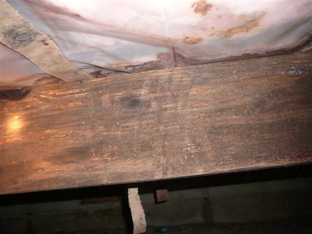

Mark P Posted October 9, 2006 Report Share Posted October 9, 2006 I had an interesting conversation with an agent today. I had written up a crawl space because all the air vents had been blocked with insulation. I do not inspect for mold, but I did identify that the wood girder was covered in a black substance and the wood was slightly soft. I recommend that the vents be opened (except during freezing weather) and the dirt ground be covered with 6mil plastic to help prevent moisture from coming up from the ground. The ageant said they had a mold guy speak at one of there meetings and he informed them that the vents should always (ALWAYS) be closed, to keep moisture out, and plastic should never be placed in the crawl space because mold grows underneath. I think I'm going to try and find out who this mold guy is and give him a call, I can't believe our recommednations are completly opposite. Am I missing the boat here? Mark Download Attachment: girder 1.jpg 48.34 KB Download Attachment: girder.jpg 42.4 KB Quote Link to comment Share on other sites More sharing options...
hausdok Posted October 9, 2006 Report Share Posted October 9, 2006 Hi, No, you are not missing the boat. There are several things in play. The mold guy might be right if the outside relative humidity in your area is so high in summer that it will migrate into the cooler crawlspace and condense all over everything. However, leaving soil - any soil- uncovered in a crawlspace will result in about 11 gallons of water evaporating out of 1000 s.f. of soil every 24 hours. Close those vents and where does it go? If the vents are closed and you create a sealed crawlspace, the soil, and the foundation walls, need to be capped and sealed very tightly, and then that space needs to be conditioned and become part of the conditioned space of the home, otherwise you create a petri dish. If the soil is capped properly and the vents are left open, moisture-laden air will migrate into the crawlspace in the summer and probably condense all over everything, if, like I said above, the r.h. in the crawlspace is less than that outside. So, in that circumstance, it might make more sense to close the vents in the summer and open them in the winter when the air is drier. Properly capping the soil is a key element to that. If the barrier is put down poorly and mold spore does develop beneath the plastic it can spread out onto areas that aren't capped and then mold spore gets airborne and will germinate on mold-friendly areas such as dampened lumber. The barrier has to be sealed at the perimeter and at overlapping joints. Do it right, and the soil beneath becomes completely saturated with all that moisture that's unable to escape and evaporate into the crawlspace and it reaches equilibrium. Do it wrong, and it continues feeding higher levels of moisture into that air 24/7/365 wherever the soil is uncovered. You need to become better acquainted with the science of this. Go here: http://www.advancedenergy.org/buildings ... wl_spaces/ and download a copy of Closed Crawlspaces - An Introduction to Design, Construction and Performance and you should have no problem debunking Mr. Mold is Gold if you take the time to study the research on this site. While I'm at it, what the hell is with that plastic on the underside of those joists? That vapor barrier needs to be against the heated floor, not on the underside of the insulation where moisture that's naturally moving through diffusion into that crawlspace will encounter that cold plastic, condense and form a mold farm in the joist bays which have now been turned into petri dishes (Note the stains). You've got some pretty poorly informed builders in that town by the looks of things. ONE TEAM - ONE FIGHT!!! Mike Quote Link to comment Share on other sites More sharing options...
Chad Fabry Posted October 9, 2006 Report Share Posted October 9, 2006 Also, the wrong side vapor barrier in your photo is slowly turning the flooring system into compost. Quote Link to comment Share on other sites More sharing options...
