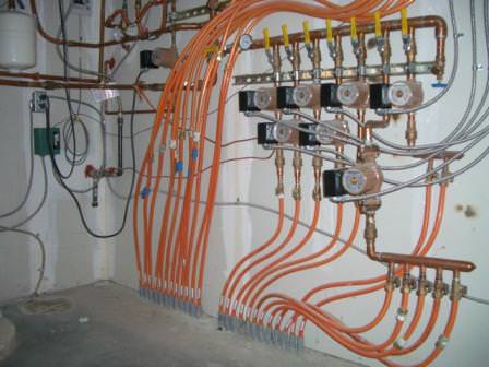

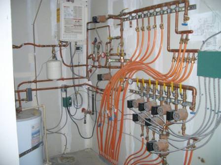

randynavarro Posted October 25, 2006 Report Share Posted October 25, 2006 Originally posted by kurt There is no way to install a passive/active circulated loop w/a tankless to eliminate the wait & standby loss. You wait, & you waste energy. Not true. I have a re-circ loop installed on my own home and it works great. . . .HOWEVER, I also supply my entire hydronic in-slab heating system from the same on-demand unit. There's so many valves, pumps, lights and gizmos on my system that my head spins every time I try and decipher what the whole system is doing. I think my radiant heat guy tricked out a way to get the re-circ loop in there somehow. There may not be a way for Buster to get a re-circ loop on his "plain jane" system. Quote Link to comment Share on other sites More sharing options...
kurt Posted October 25, 2006 Report Share Posted October 25, 2006 Totally different animal. Supposedly, there's some sort of switching mechanism available that allows one to kick in a circulator when the unit fires, or something like that, so you get water quicker; I think it's the industry's "answer" for the wait & waste thing. You got any pictures or spec's of your system? I'm contemplating one for my own building project. Quote Link to comment Share on other sites More sharing options...
randynavarro Posted October 25, 2006 Report Share Posted October 25, 2006 Kurt - I'll get some pictures posted soon. I think its a pretty cool system if I may say so myself. I'm still trying to figure if the guy that installed it is a genius or this was one of his first projects of this scope. I'm heating around 2300 sq. ft. and have 6 different zones. It took him several return trips to tweak and modify many of the components but has now been working well for 2 + years - no problems. Don't know if I'm saving energy - I've never heated this much space before with forced air or other systems so I can't compare. The heat quality is definitely much better. No blowing air or dust or drafts. Everything is 'consistent'. And with so many zones, I can just heat whatever area we're using (which is now almost all of them given our recent addition of 4 kids). This will be our first winter with most all zones running. We'll see if the on-demand unit can handle the load. BTW, I'm also supplying potable water to two bathrooms from the same on-demand unit. I'm having a hard time believing myself that it will handle but we'll see. Again, the guy was either a genius or he was out of his league on this project. Quote Link to comment Share on other sites More sharing options...
kurt Posted October 25, 2006 Report Share Posted October 25, 2006 Sounds like a competent installation. If the design is right, it will do everything fine, I'm sure. The systems I see all need tweaking for a couple months; getting all the mixing valves balanced & thermostat settings on target takes a while, but once you got it in line, you never have to touch it again. What's your flooring material? A common balance in Chicago is 1:1, i.e., one linear foot of pipe for one square foot for ceramic stone floor, and 2:1 for carpet or wood. Do you recall how many linear feet of tubing he installed per square foot of floor area? Quote Link to comment Share on other sites More sharing options...
randynavarro Posted October 26, 2006 Report Share Posted October 26, 2006 Kurt, here's a few pics of my system. If anybody wants more specifics I'll do my best to comply. Anybody want to 'confess' how they'd inspect something like this? Download Attachment: Heat1.JPG 63.11 KB Download Attachment: Heat2.JPG 64.24 KB Download Attachment: Heat3.JPG 65.76 KB Quote Link to comment Share on other sites More sharing options...
Brian G Posted October 26, 2006 Report Share Posted October 26, 2006 Originally posted by randynavarro Anybody want to 'confess' how they'd inspect something like this? Oy! I sure as hell wouldn't pretend to understand it, so I'd look for obvious problems (leaks, corrosion, wiring issues, etc.) and just try to run the stuff and see if it worked. Beyond that, disclaim and recommend review by some who does actually understand it. Brian G. "I Don't Know" Are Not Forbidden Words [?] Quote Link to comment Share on other sites More sharing options...
kurt Posted October 26, 2006 Report Share Posted October 26, 2006 Ya know, when you start breaking the thing down into the simple component parts, they really aren't that complicated. They just look that way on the front end. The really hard part is the stuff we can't see anyway, i.e., how much tubing is in the floor. Everything else is basic hydronic heating, multiplied to several zones & controls. Personally, I dream of the day I can build a new home w/that system. Quote Link to comment Share on other sites More sharing options...
randynavarro Posted October 26, 2006 Report Share Posted October 26, 2006 You're right Kurt. The concept is very simple. But the combination of parts, valves, mixers etc. can really get very complicated. The physics for lack of a better term, of water flow is the tricky part. I'm starting to see more of these radiant heat systems yet I've never seen two that are the same. Its funny how we'll see the typical forced air, natural gas heat duplicated over and over again but not on radiant systems. I've seen components and parts that I've never seen before and haven't seen since. Why are they installed that way? I've got boiler plate in my report that basically says these things are really more of an art form than an excact science. Like Brian, I'm just looking for leaks, corrosion, and bad wiring. Whether the system performs as intended is way outside the scope of my work! Quote Link to comment Share on other sites More sharing options...
randynavarro Posted October 26, 2006 Report Share Posted October 26, 2006 Originally posted by kurt What's your flooring material? 4" concrete slabA common balance in Chicago is 1:1, i.e., one linear foot of pipe for one square foot for ceramic stone floor, and 2:1 for carpet or wood. Do you recall how many linear feet of tubing he installed per square foot of floor area? We didn't calculate that way. I installed the tubing myself under the guidance of the contractor - its the easiest part!! We basically "filled" the flooring using a simple pattern: One run 6" from the exterior perimeter and the adjacent run 12" from that one. After that we ran 18" on center. Just rolled the tubing back and forth across the floor avoiding the interior wall plates. Maximum tubing run is 300'. The largest zone in the home which is Living Room, office, Kitchen and hallways was 5-300' runs (give or take). Here's a couple pics. Download Attachment: FloorTubing1.JPG 35.15 KB Download Attachment: FloorTubing2.JPG 37.48 KB Quote Link to comment Share on other sites More sharing options...
kurt Posted October 26, 2006 Report Share Posted October 26, 2006 You don't have anything on the concrete, i.e., no finish flooring? Not that I'm opposed; I really like dyed finished concrete. And, what's your heat source? Most of the reason we never see two system's the same is everyone is approaching this like they do everything else in construction; they ignore the mfg's. & make stuff up on their own. At least, that's how it happens in Chicago. The whole concept of primary & secondary pumping loops is (more or less) ignored by most contractors. Length of run is argued about, spacing of tubing, some of the systems use glycol heat exchangers, some don't, etc., etc..... It's a lot of parts. What gets complicated is when the installer stuffs everything into the teeny tiny closet, and we can't see anything. Quote Link to comment Share on other sites More sharing options...
randynavarro Posted October 27, 2006 Report Share Posted October 27, 2006 Originally posted by kurt You don't have anything on the concrete, i.e., no finish flooring? And, what's your heat source? Oh, sorry - misunderstood the first time. Ceramic tiles in bathrooms. Carpet. Floating engineered hardwoods in Kitchen, Hall and Office. Hardwoods are performing tremendously BTW. Heat source? Thought is was clear before. Its a natural gas on-demand tankless heater. Its the small white box on the high part of wall at the upper left of the first set of photos. Quote Link to comment Share on other sites More sharing options...
kurt Posted October 27, 2006 Report Share Posted October 27, 2006 Heat source? Thought is was clear before. Its a natural gas on-demand tankless heater. Its the small white box on the high part of wall at the upper left of the first set of photos. Oh yeah; duh. I got so into your heating system, I forgot what the thread was about.... Quote Link to comment Share on other sites More sharing options...
