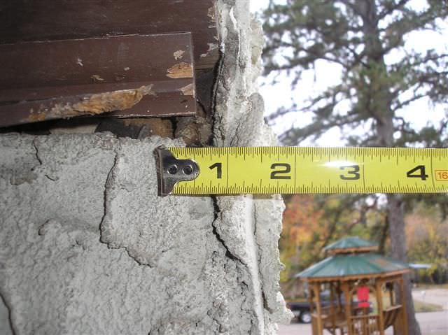

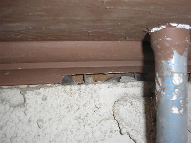

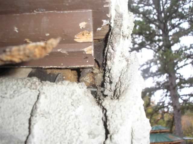

Tim H Posted November 16, 2006 Report Share Posted November 16, 2006 Not much Stucco in these parts (central Alabama, mostly brick veneer and EIFS), and this is my first Stucco in over 200 inspections. I could not view a cross section from any penetrations, but I got a peek from some areas where the trim/fascia was damaged. I could make out felt paper vapor barrier and a composition substrate. I did not see any lathe that I have ever seen photos of or reference to. Rather, there was a heavy guage wire that appears to be spaced 1" apart vertically (I could only see one horizontal wire). The system thickness was difficult to determine because of the irregular surface finish, but there seems to be only two coats. Accessory joint were present at the corners of windows and doors, and there were only a very few minor hairline cracks present. The home and exterior finish are 34 yrs old. This doesnt appear to be a conventional application (at least one that I am familiar with through training or reading), but it is holding up very well. Any thoughts on what type of system this is, and why there is no mesh lathe present? Thanks. Tim Howe Download Attachment: P7190071.JPG 57.28 KB Download Attachment: P7190072.JPG 68.84 KB Download Attachment: P7190074.JPG 48.76 KB Link to comment Share on other sites More sharing options...
stuccoman Posted November 17, 2006 Report Share Posted November 17, 2006 In your third picture it looks like there is a wire mesh of some kind. It looks like 3 cote work with some thin spots! Link to comment Share on other sites More sharing options...
Tim H Posted November 17, 2006 Author Report Share Posted November 17, 2006 Stuccoman- "In your third picture it looks like there is a wire mesh of some kind." It does seem to be a wire mesh, and the openings between the mesh appear to be 1". Is this something you have seen before? I am familiar only with the fine mesh such as that pictured on your web site. Thanks for the reply. Tim Link to comment Share on other sites More sharing options...

Bill Kibbel Posted November 17, 2006 Report Share Posted November 17, 2006 I get to see all kinds of stucco applications on old buildings that we do not consider a "conventional application" by todays published standards. I've come across 1" wire mesh and even 2". Heck, I had a 300 year old log home that had vertical wood battens spaced at 1.5-2". I only get concerned if there is significant loss of bond -- or chickum' wire. Link to comment Share on other sites More sharing options...
