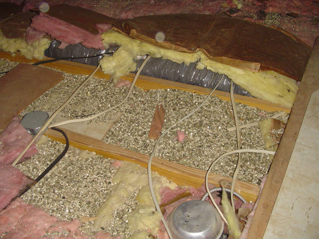

Bain Posted January 23, 2007 Report Share Posted January 23, 2007 Here's a link I used this past Friday afternoon to 'splain what was lurking in an attic. The EPA's photo is pretty similar to the photo I snapped, huh? John Download Attachment: DSC06820a.jpg 202.08 KB http://www.epa.gov/asbestos/pubs/insulation.html Quote Link to comment Share on other sites More sharing options...

hausdok Posted January 23, 2007 Report Share Posted January 23, 2007 Originally posted by Bain Here's a link I used this past Friday afternoon to 'splain what was lurking in an attic. The EPA's photo is pretty similar to the photo I snapped, huh? John Download Attachment: DSC06820a.jpg 202.08 KB http://www.epa.gov/asbestos/pubs/insulation.html Did you have it tested? Not all vermiculite contains asbestos. More than once, I've grabbed a teaspoon of vermiculite, closed it in an envelope and directed the client to take it to a local lab and spend $30. to get it tested for asbestos. So far, only about 50% of those tests have come back positive for asbestos. OT - OF!!! M. Quote Link to comment Share on other sites More sharing options...
Bain Posted January 23, 2007 Report Share Posted January 23, 2007 A guy took a sample yesterday that was zapped off to be tested by a lab. Also, FYI, the buyer called a few mitigation companies, and the cost of removal is four or five K. The air handler is in the attic, and we all know that closed systems don't really exist . . . Quote Link to comment Share on other sites More sharing options...
hausdok Posted January 23, 2007 Report Share Posted January 23, 2007 Originally posted by Bain A guy took a sample yesterday that was zapped off to be tested by a lab. Also, FYI, the buyer called a few mitigation companies, and the cost of removal is four or five K. Sounds about normal. The air handler is in the attic, and we all know that closed systems don't really exist . . . Neither does the adult or kid exist who has never breathed asbestos if they've ever ridden in a car with the windows open. [:-magnify OT - OF!!! M. Quote Link to comment Share on other sites More sharing options...
Bain Posted January 23, 2007 Report Share Posted January 23, 2007 Hey, Mike. The results came back on the vermiculite today and they were negative, which surprised me. I've come across that stuff maybe ten times before and the tests were always positive. Now I feel like sort of a goof for telling my customer the insulation almost assuredly contained asbestos, but have learned my lesson. Don't ya just hate learnin' those lessons . . . ? Quote Link to comment Share on other sites More sharing options...
