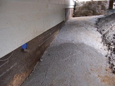

Brandon Whitmore Posted April 4, 2007 Report Share Posted April 4, 2007 Inspected a new construction house today. The house is a daylight basement style, but has a crawlspace beneath the lower level. The top of the foundation sits at a lower grade than the street. The foundation has been damp- proofed (tar type substance) due to the living space installed below grade. The majority of the foundation is not visible along the front (street side) of the home- the foundation is covered with housewrap with a standard tarp under the housewrap (tarp such as is used for camping). The Realtor cut back the tarp to see what was behind it and that is when I noticed that the foundation does not appear to extend above grade, and in some areas the OSB wall sheathing is actually damp- proofed behind the tarp. I will try to post pictures of this concern (one of many) and would appreciate any comments on this installation. Download Attachment: .jpg"] 100_0597[2].jpg 53.76 KB Download Attachment: newconstruction.jpg 192.91 KB Download Attachment: newconstruction2.jpg 149.79 KB Quote Link to comment Share on other sites More sharing options...
zeb Posted April 4, 2007 Report Share Posted April 4, 2007 Wow osb is not good below grade. Quote Link to comment Share on other sites More sharing options...
Brandon Whitmore Posted April 4, 2007 Author Report Share Posted April 4, 2007 Has anyone ever seen this style of installation where OSB has been damp proofed along with the foundation and a tarp installed over the top? Quote Link to comment Share on other sites More sharing options...
Jim Katen Posted April 4, 2007 Report Share Posted April 4, 2007 Originally posted by Brandon Whitmore Has anyone ever seen this style of installation where OSB has been damp proofed along with the foundation and a tarp installed over the top? No. It's a complete mess. Hit 'em with both barrels. - Jim Katen, Oregon Quote Link to comment Share on other sites More sharing options...
Scottpat Posted April 4, 2007 Report Share Posted April 4, 2007 Originally posted by Brandon Whitmore Has anyone ever seen this style of installation where OSB has been damp proofed along with the foundation and a tarp installed over the top? Damp proofed OSB is about as close to an oxymoron as you can get. Quote Link to comment Share on other sites More sharing options...
Chris Bernhardt Posted April 4, 2007 Report Share Posted April 4, 2007 yea, thats like trying to damp proof a sponge. Chris, Oregon Quote Link to comment Share on other sites More sharing options...
Brandon Whitmore Posted April 4, 2007 Author Report Share Posted April 4, 2007 My recommmendations for repair on the front of the home are to re- grade/ slope where needed, install a proper housewrap where needed and install siding once there is an adequate clearance of 6-8" between the top of the foundation and ground level-- would anyone recommend anything further? Also, regarding their interesting use of a tarp. I am wondering if this is an attempt at water proofing the foundation since the basement I joist framing is sitting on a pressure treated sill bolted to the foundation footing-- my concern with this installation is moisture wicking up off the sill plate onto the I joists-- I have pictures if interested. Slight thread drift-- in the crawlspace of this home there is zero ventilation with 2 mechanical vents blowing air around in the crawlspace (nowhere for air to go). There is some moisture in the crawlspace and heavy dampness on knee wall sheathing and framing throughout with about 3 colors of mold/ mildew type growth. The exposed fasteners throughout (subfloor down) are pretty heavily rusted and have moisture droplets hanging on the fasteners. The insulation is damp/ moist throughout and was actually dripping in some areas on one wall (toward front of home). My recommendations are to remove all subfloor insulation, install a proper ventilation system and dry things out. I also recommended consulting with a mold expert for evaluation/ testing. Am I missing anything? I am pretty worried about liability on this home and want to get as specific as possible for the submitted report. THANKS. Quote Link to comment Share on other sites More sharing options...

Jim Katen Posted April 5, 2007 Report Share Posted April 5, 2007 Originally posted by Brandon Whitmore My recommmendations for repair on the front of the home are to re- grade/ slope where needed, install a proper housewrap where needed and install siding once there is an adequate clearance of 6-8" between the top of the foundation and ground level-- would anyone recommend anything further? I'd tell them to expose every square inch of OSB that had been below grade and call me back to look at it and make further recommendations at that time. Also, regarding their interesting use of a tarp. I am wondering if this is an attempt at water proofing the foundation since the basement I joist framing is sitting on a pressure treated sill bolted to the foundation footing-- my concern with this installation is moisture wicking up off the sill plate onto the I joists-- I have pictures if interested. There's supposed to be a moisture break between the sill & the concrete. In our area, that's usually polyethylene foam sill seal or something similar. If the I-joists have been below grade, I'd be concerned about them too. Slight thread drift-- in the crawlspace of this home there is zero ventilation with 2 mechanical vents blowing air around in the crawlspace (nowhere for air to go). There is some moisture in the crawlspace and heavy dampness on knee wall sheathing and framing throughout with about 3 colors of mold/ mildew type growth. The exposed fasteners throughout (subfloor down) are pretty heavily rusted and have moisture droplets hanging on the fasteners. The insulation is damp/ moist throughout and was actually dripping in some areas on one wall (toward front of home). My recommendations are to remove all subfloor insulation, install a proper ventilation system and dry things out. I also recommended consulting with a mold expert for evaluation/ testing. Am I missing anything? I like all of your recommendations except the part about the mold expert. Invariably and without a sliver of a doubt, the "expert" they call will be a complete idiot. I am pretty worried about liability on this home and want to get as specific as possible for the submitted report. THANKS. If you're worried about liability, just write your report in a clear, conversational tone. Don't be afraid to say that the house is a mess and don't be afraid to use scary words. This isn't the time to worry about offending someone. As your write the report, think about how you're actually doing this builder a favor. He might feel a sting from your report now, but if this stuff weren't discovered for several months and someone got sick because of it, he could very well be bankrupted by it. So where is this house? Who's the builder? If it's in Washington or Yamhill counties, I *know* that the building department is going to want to know about it. -Jim Katen, Oregon Quote Link to comment Share on other sites More sharing options...
Brandon Whitmore Posted April 5, 2007 Author Report Share Posted April 5, 2007 Jim, Home is located in SE Portland (N. of Foster Rd. on 141st (Multnomah or Clackamas County- will have to get a map). Since I am not allowed to disclose anyhing to anyone but my client-- shouldn't I get written permission from the client prior to notifying the building department? As far as the mold guy being a complete idiot, I would not argue that point. Shouldn't the growth be at least evaluated further? I am not sure who the builder is on this home, but would prefer not to inspect his houses in the future. (getting a headache on this one -- you should see their house next door) Quote Link to comment Share on other sites More sharing options...
Jim Katen Posted April 5, 2007 Report Share Posted April 5, 2007 Originally posted by Brandon Whitmore Jim, Home is located in SE Portland (N. of Foster Rd. on 141st (Multnomah or Clackamas County- will have to get a map). Since I am not allowed to disclose anyhing to anyone but my client-- shouldn't I get written permission from the client prior to notifying the building department? I didn't mean to suggest that you call the building department. I'd tell my client to do it. As far as the mold guy being a complete idiot, I would not argue that point. Shouldn't the growth be at least evaluated further? Nope. I'd skip that step and go right to treatment. They should expose every inch of OSB that had been below grade and hire you to come back to identify which sheets need to be replaced. Then have a PCO treat both sides of the rest with Timbor or Boracare. I am not sure who the builder is on this home, but would prefer not to inspect his houses in the future. (getting a headache on this one -- you should see their house next door) He's incompetent. Is that a finished concrete walkway in one of those photos? Woof! - Jim Katen, Oregon Quote Link to comment Share on other sites More sharing options...
