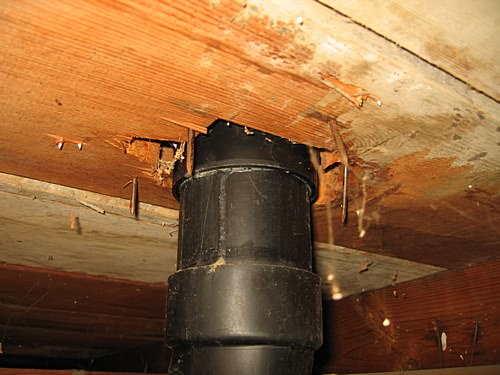

Chris Bernhardt Posted May 10, 2007 Report Share Posted May 10, 2007 Is it OK to nail sewer flanges to the subfloor? I thought I have always seen them screwed down. I don't like the idea of nailing. I would imagine flange would be prone to loosening. Chris, Oregon Quote Link to comment Share on other sites More sharing options...
ozofprev Posted May 10, 2007 Report Share Posted May 10, 2007 Section 405 of the IPC: 405.4.1 Floor flanges. ...blah...Closet screws and bolts shall be of brass. Flanges shall be secured to the building structure with corrosion-resistant screws or bolts. Quote Link to comment Share on other sites More sharing options...

homnspector Posted May 11, 2007 Report Share Posted May 11, 2007 Man, now we have to start pulling up toilets? Quote Link to comment Share on other sites More sharing options...
Chris Bernhardt Posted May 11, 2007 Author Report Share Posted May 11, 2007 Heres a nailed sewer flange from a recent inspection. Download Attachment: jse_IMG_6999.jpg 52.18 KB Chris, Oregon Quote Link to comment Share on other sites More sharing options...
