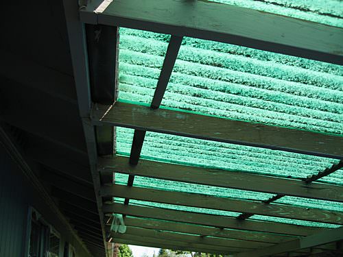

Chris Bernhardt Posted May 11, 2007 Report Share Posted May 11, 2007 We have previously discussed patio roof covers supported on the roof. What I would like to have comment on is patio covers that are supported off of the eave. What I see day in and day out are rafters attached to fascias on the truss tails of the eave overhang. I know its not right but nobody ever complains its done here all of the time. I actually see more problems where someone has attached the patio cover rafters to the side of the house. But in that case its because they have only fastened into the siding and not any structure. Should it always be written up for correction? Or just explained its not right, but everybody does it? Like I say I have seen hundreds and hundreds of these and rarely is there a problem with rafter connections to the eave. Download Attachment: jse_IMG_6863.jpg 50.88 KB Sorry the photo's a little dark, I couldn't find my lightener dily Chris, Oregon Quote Link to comment Share on other sites More sharing options...
randynavarro Posted May 11, 2007 Report Share Posted May 11, 2007 I don't really see it as a problem, but I'm willing to be educated otherwise. There isn't any weight up there (unless you live in heavy snow country, I guess) and if somebody is silly enough to walk up there, its not the joist-eave connection that's gonna fail!! Now about how ugly those things are . . . Quote Link to comment Share on other sites More sharing options...
Jim Katen Posted May 11, 2007 Report Share Posted May 11, 2007 Originally posted by Chris Bernhardt . . . What I see day in and day out are rafters attached to fascias on the truss tails of the eave overhang. I know its not right but nobody ever complains its done here all of the time. I actually see more problems where someone has attached the patio cover rafters to the side of the house. But in that case its because they have only fastened into the siding and not any structure. Should it always be written up for correction? Or just explained its not right, but everybody does it? Like I say I have seen hundreds and hundreds of these and rarely is there a problem with rafter connections to the eave. I think it depends on how well (or poorly) it's done. I've made recommendations that range from "tear it down" to "It's fine. Leave it be." In your picture, I'd be concerned with the connection between the rafter tails and the fascia. My recommendation would probably be to have a framing contractor improve the connection between the rafter tails and the fascia board. (An A34 at each tail would be fine.) Sorry the photo's a little dark, I couldn't find my lightener dily Chris, Oregon Here's a lightened version. Download Attachment: 2007510172910_jse_IMG_6863.jpg 131.2 KB - Jim Katen, Oregon Quote Link to comment Share on other sites More sharing options...
Steven Hockstein Posted May 11, 2007 Report Share Posted May 11, 2007 What about uplift during a storm? The roof is a big sail. Quote Link to comment Share on other sites More sharing options...
Chris Bernhardt Posted May 11, 2007 Author Report Share Posted May 11, 2007 We have had a number of high wind events and while I have seen only a few blow off its amazing that so many stay on happy as a clam. Chris, Oregon Quote Link to comment Share on other sites More sharing options...
Jim Katen Posted May 11, 2007 Report Share Posted May 11, 2007 Originally posted by Steven Hockstein What about uplift during a storm? The roof is a big sail. If the framing is even moderately well-installed, the roof panels on these things tend to fly off while the framing stays put. Chris & I are in a fairly protected valley where the really nasty wind storms are rare. On Columbus Day of 1962, we saw gusts of 167mph, but haven't seen anything that bad since. - Jim Katen, Oregon Quote Link to comment Share on other sites More sharing options...
sbrooten Posted May 11, 2007 Report Share Posted May 11, 2007 Okay, how about this... The 167 mph wind blows through the area and cheesy fiberglass/plastic panels blow off. Mr. Do-It-Yourselfer gets pissed, goes down to Home Depot and buys plywood and shingles so the d----- thing won't blow off again. Now I see a big problem, as the load isn't transferred to the wall. I won't count on things staying as they are now. I will point it out and let the chips fall where they may. Quote Link to comment Share on other sites More sharing options...
Jim Katen Posted May 11, 2007 Report Share Posted May 11, 2007 Originally posted by sbrooten Okay, how about this... The 167 mph wind blows through the area and cheesy fiberglass/plastic panels blow off. Mr. Do-It-Yourselfer gets pissed, goes down to Home Depot and buys plywood and shingles so the d----- thing won't blow off again. Now I see a big problem, as the load isn't transferred to the wall. I won't count on things staying as they are now. I will point it out and let the chips fall where they may. So you'd recommend altering the construction of the patio cover based on your guess about what a homeowner might do in reaction to a rare windstorm that might happen? Frankly, that's too many contingencies for me. I'd just tell them to secure the framing well. If we get another once-in-a-hundred-year storm, we'll have bigger problems than improper subsequent repairs to patio covers. - Jim Katen, Oregon Quote Link to comment Share on other sites More sharing options...
