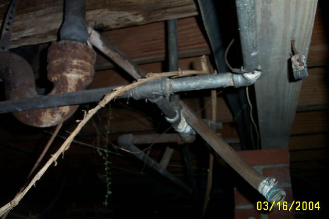

Danny Pritchard Posted March 18, 2004 Report Share Posted March 18, 2004 I found this to be interesting.This is a 1930-40's home.Someone who did not think the tub drained like it should added an overflow hose line to make sure nothing ever backed up. Download Attachment: Tub overflow line.jpg 61.5 KB Quote Link to comment Share on other sites More sharing options...
Terence McCann Posted March 18, 2004 Report Share Posted March 18, 2004 Or it could be a home made vent (although it should be pointed up).[:-paperbag] I like the galvanized piping too! Quote Link to comment Share on other sites More sharing options...
