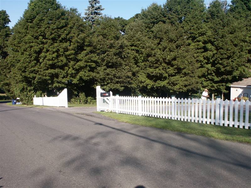

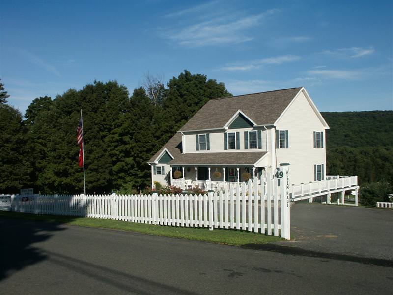

hausdok Posted August 25, 2007 Author Report Share Posted August 25, 2007 Hi John, Are those systems down there set up so that only some of the fixtures supply the greywater, as in the article? Do they make any effort to capture the rain? Yeah, I heard that there wasn't a whole lot of rain this year, but how about those years when there is? I guess I never realized how much the snowbirds impact Florida. My parents have both moved down there. My father is in Palm Coast and my mom lives in Duneeden (sic). My mother and a couple of her sisters moved down there and live within a few miles of each other. My dad and stepmother do the snowbird thing. Here's his summer project back up in New York - a new picket fence. Over 80, and he was out there in 100+ degree heat putting up that fence on his own (He built the house himself 3 years ago - its a modular that came as a shell with the insulation and rock in. It's for sale if anyone is interested.). Talk about stubborn! My stepmother says that he did a good job and the townsfolk like it so much that they're driving by in the evening to look at it. Small town - 1100 people - something like a new fence is kind of a big deal. Image Insert: 74.59 KB Image Insert: 114.61 KB Image Insert: 70.38 KB Image Insert: 114.61 KB Quote Link to comment Share on other sites More sharing options...

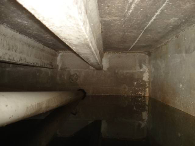

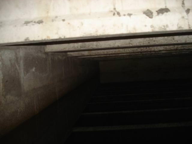

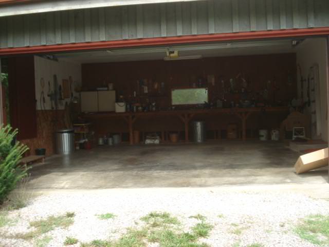

Erby Posted August 25, 2007 Report Share Posted August 25, 2007 I did this one the other day that collected all the rainwater into a cistern under the garage. The cistern was under the complete two car garage. A concrete block wall split the cistern in half from side to side. All the rainwater went into the rear half and filtered thru the concrete block wall into the front half where the pump system picked it up and delivered it to the pressure tank/water system. BUT, the greywater just went down over the hill. Image Insert: 53.96 KB Image Insert: 24.35 KB Image Insert: 31.72 KB The white pipe in the third photo is the gutter dump from the front of the house/garage into the rear half of the cistern. Image Insert: 40.37 KB I see a bit of cisterns but this is the first one I've seen that used a concrete block wall as the filter!! Quote Link to comment Share on other sites More sharing options...
